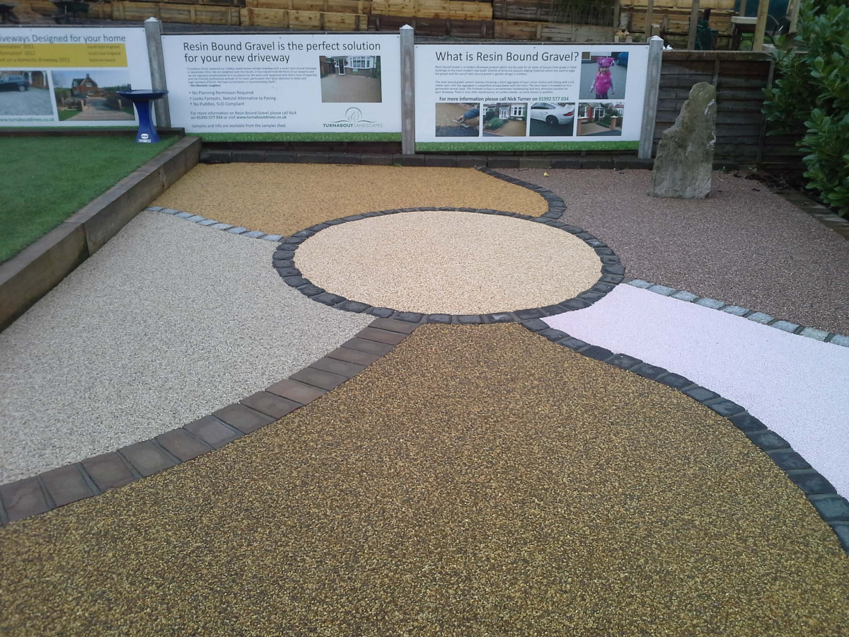

:unsure: :unsure: :confused: ...... this sort of thing James ??
seen some locally, recently ..... I like it (y):cool:

Yes much like that.

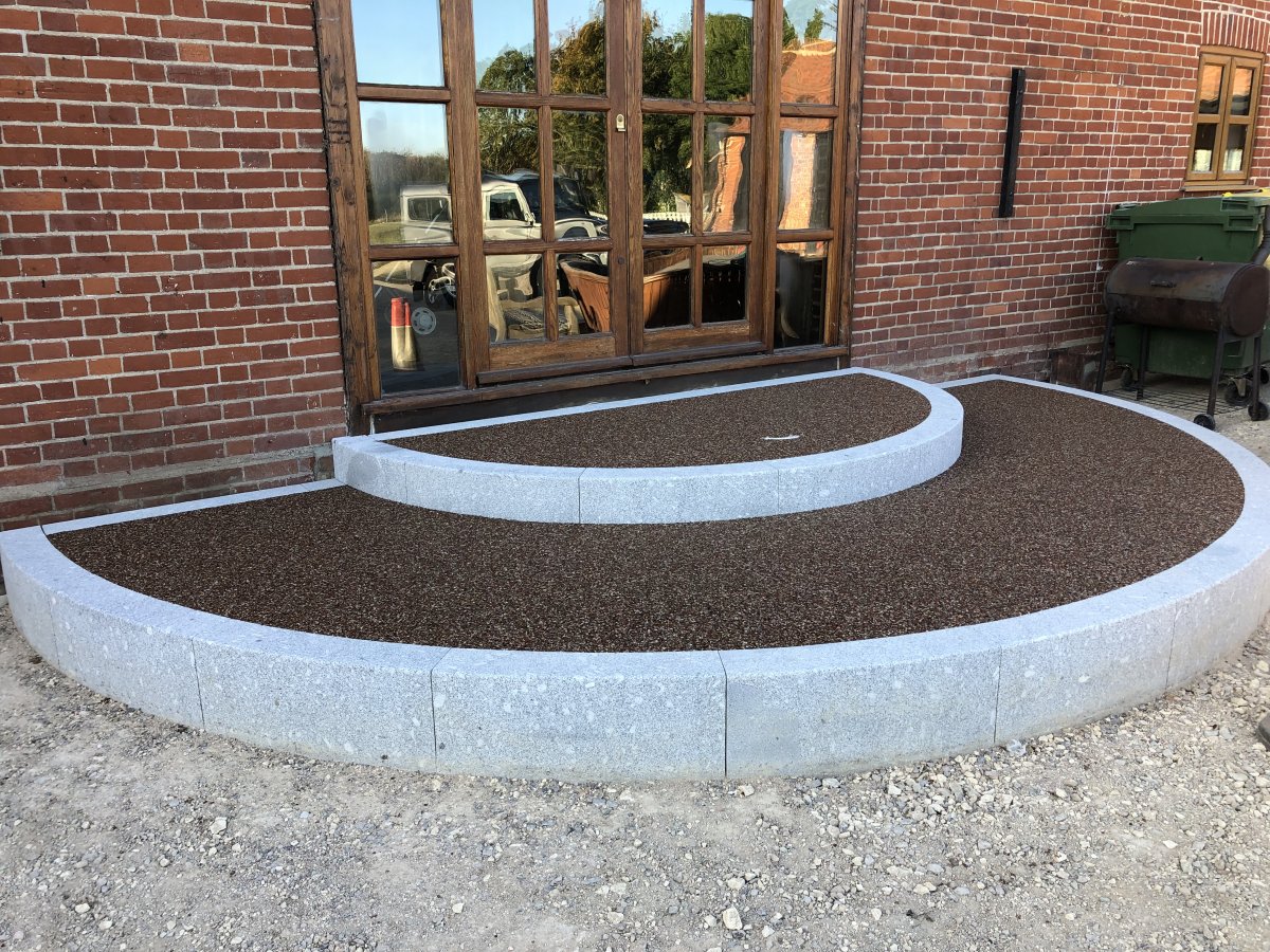

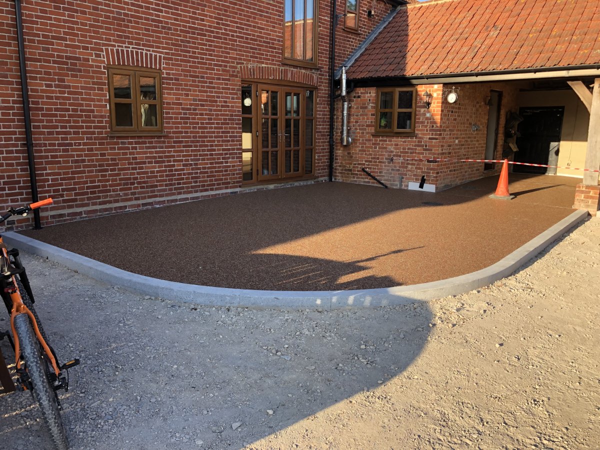

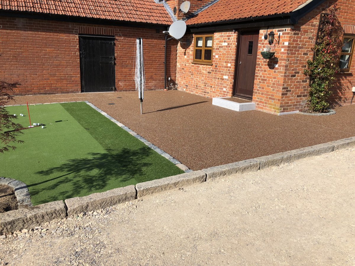

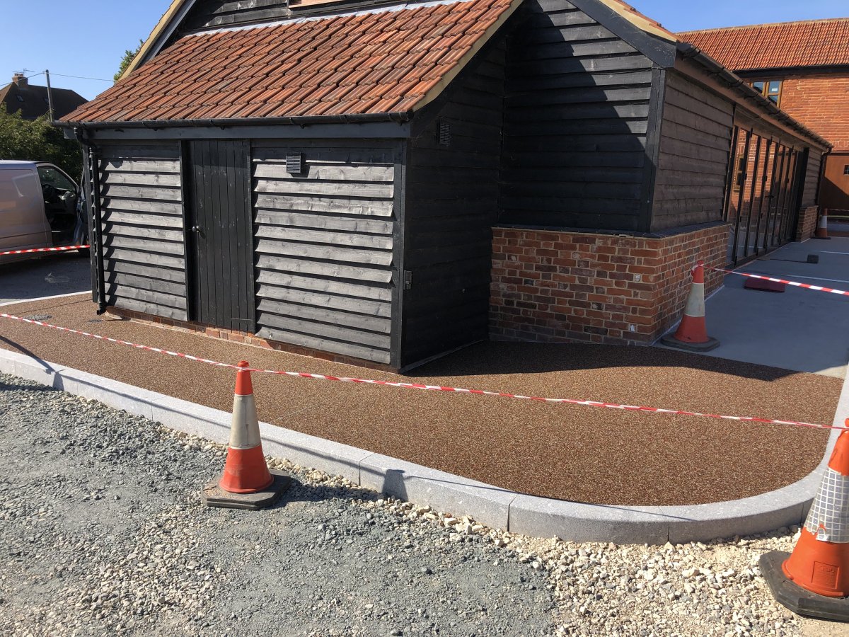

Resin was ok to lay, I’d recommend going on a course if you want to do it yourself. It’s not rocket science, but you do need to do it right, there are ways to cut corners and potentially f**k it up. I took the view that the product is too expensive to not make every effort to do it right.
I laid it on concrete, there are other sub bases suitable and possibly better? But I had more confidence in laying it on concrete, as it was the first time I’d laid it, that in itself had its complications which required a bit of outside the box thinking to best prevent future problems, but all came out well in the end👍

View attachment 9626View attachment 9627View attachment 9628View attachment 9629
Cheers mate, looks great!
I spoke to a few manufacturers and apparently tarmac or concrete is best

Yes tarmac or concrete, but the company I used for the resin, do a grid system which potentially looks good, I just need to use it somewhere other than a customers job for the first time, just to be a bit more confident in using it, but it has a lot of installation benefits tbh.
Concrete was definitely the way for me on that particular job. Imo you can’t resin over any joints though, not long term anyway, so I made provisions for the concrete joints in the resin surface. In some ways this actually aided the installation process. But just things you’ve got to think about.
