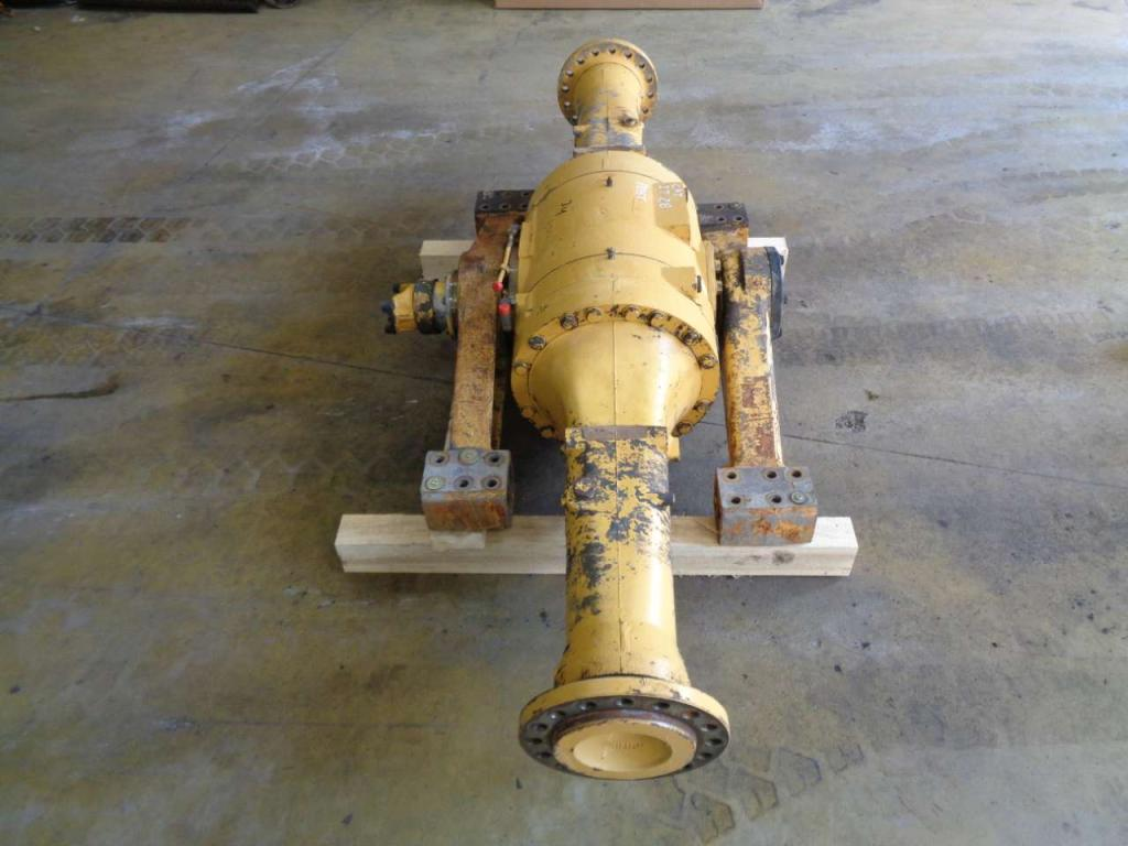

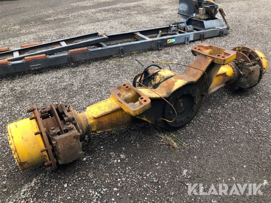

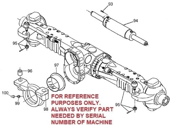

much like a 'duck's' (360 wheeled excavator) pendle axle axle allows oscillation on the front steering/driven axle
does that axle have a second pivot point about the circular mount on the diff. nose side?

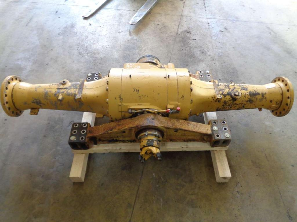

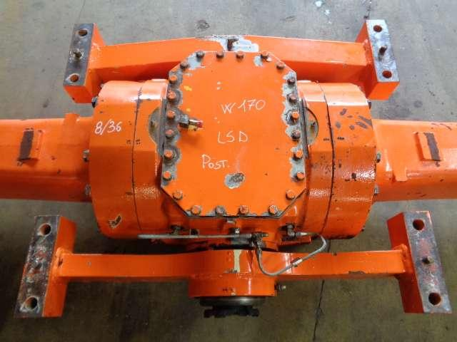

practically in the very old international dresser it has a support that they call cradle you do not know what you call it, it was disassembled and brought to a turner to rectify it and restore the game of tolerance, which had formed due to excessive wear. I think it serves to stabilize the machine on uneven ground and keep the wheels attached to the ground, such as on bumps, and to prevent the wheels from coming off the ground and remaining suspended overhanging and losing grip like a stabilizer bar I think it is, am I wrong ??
assale anteriore
CASE WX 170​
ASSALE POSTERIORE PER CATERPILLAR 928 F​
ASSALE POSTERIORE PER FIAT HITACHI W 170​

That axle looks like a Volvo unit to me. Always know that type axle configuration to be a trunion mounted axle.
the photos I posted are not of the old dresserer international but of unavolvo, as you rightly pointed out, I could not take real photos of the mechanical part in question is under repair, just to give an idea of what I meant, the shape however, it is not that the support supports the swinging rear axle bridge and the differential box with the transmission, as you have rightly specified above, I take this opportunity to offer you my best wishes, thank you all for your kind clarifications.
