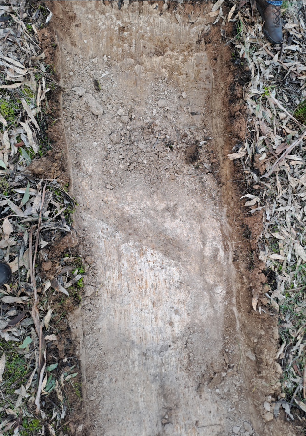

Well ..... contrary to expectations, I have to admit this tracer performed really well.
The cable is about 600mm deep and the tracer was not showing any drop in performance beyond 150m.
It's certainly not 'professional grade', but I admit I'm quite impressed how well it worked.
For the aud$65 (30gbp) it cost me, I feel I got very good value.
Once I had a line, I used a wide bucket to see if any evidence of the original trench could be seen - the 4" slot was unmistakable.
