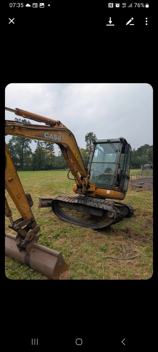

Anyone able to date this case for me? Think it's a cx35. Belongs to a local Scout campsite and needs idlers etc ๐Ÿ‘

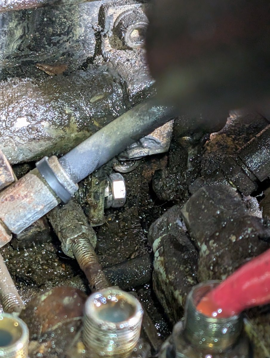

Hi , I'm the fool that said I would see what I could do to repair said digger.
Newest problem is that it has no drive on the left track , the left tracking stick has no resistance like it's not attached.
Anyone come across this before? I'm a Generator engineer by trade so this is new to me but it's all nuts and bots I guess

We try to avoid the bots if we can, but a generator engineer in our midst is good ๐Ÿ™‚
If the tracking stick doesn't feel like it's connected it probably isn't, get digging and it always does go back together easier than it comes apart ๐Ÿ˜

Could be a broken linkage or a connecting pin worked out

Totally forgot to post , I finally got round to getting the cx35 stripped down , found that the nut on the end of the tracking control rod had vibrated off .. nut re-secured with an anti vibration washer and some (a lot ) of swearing it's up and mobile again... Now to source rollers and idlers for it ๐Ÿคฆ๐Ÿผ
