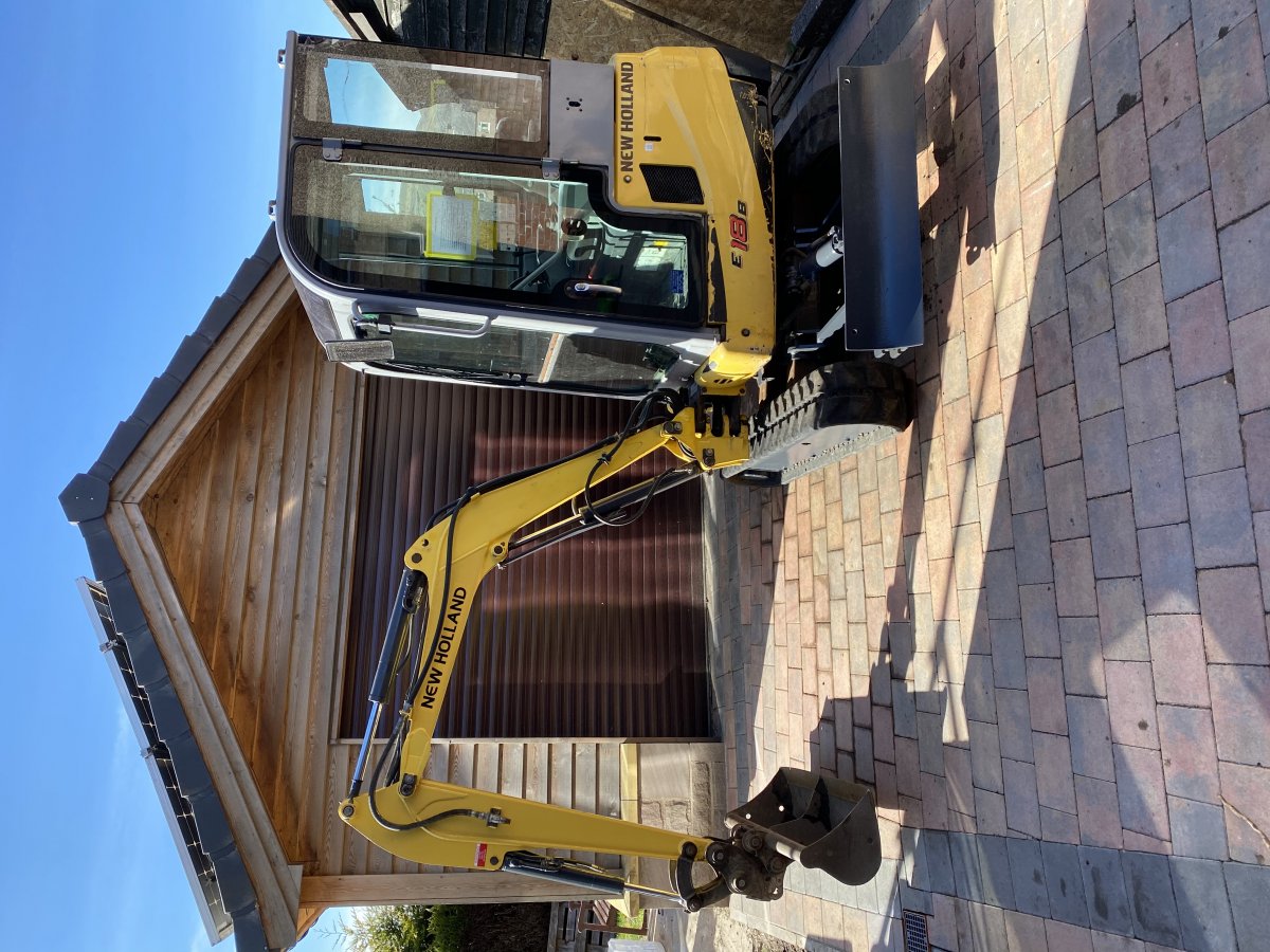

Iv got a new Holland E18B, exact same machine as the case, had the same problem with the undercarriage, just got it back yesterday from getting welded.
Absolutely great machine, hired lots of 1.5t machines in the past and far prefer the E18B! that one your buying is also way underpriced!

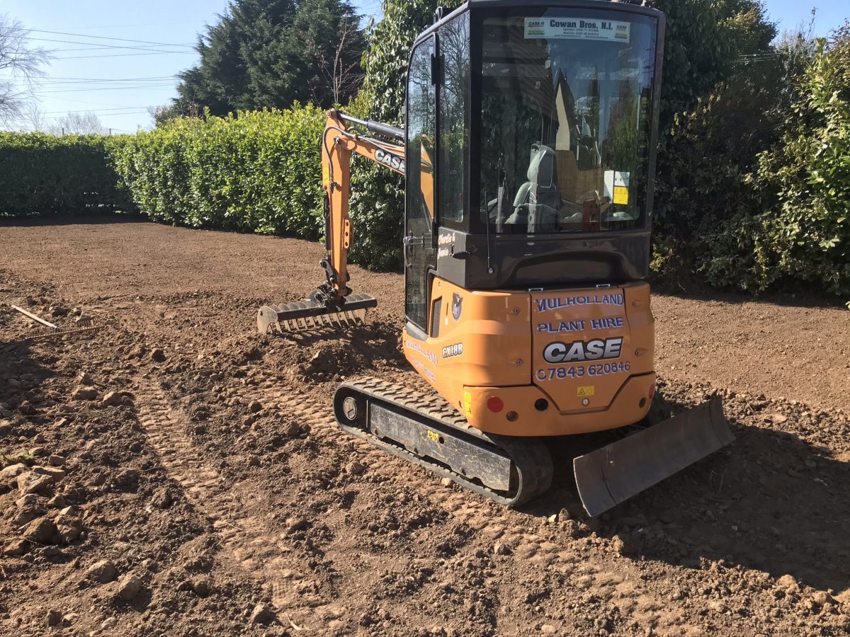

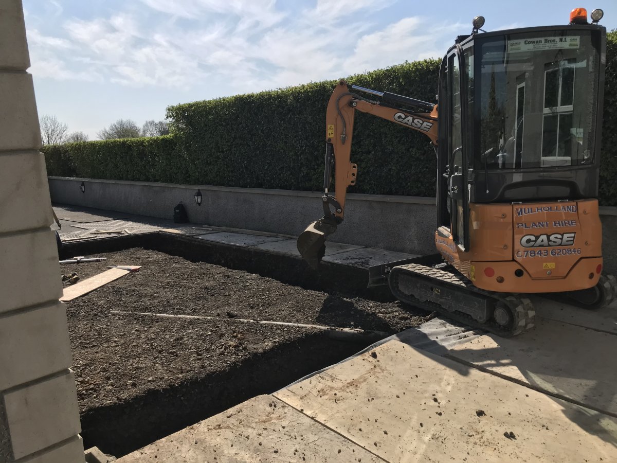

I love mine. Here’s a couple of jobs I’v just finished with it. Had it in a real tight spot today. I had to take the blade extensions off and narrow in my tracks. First time in a while.
