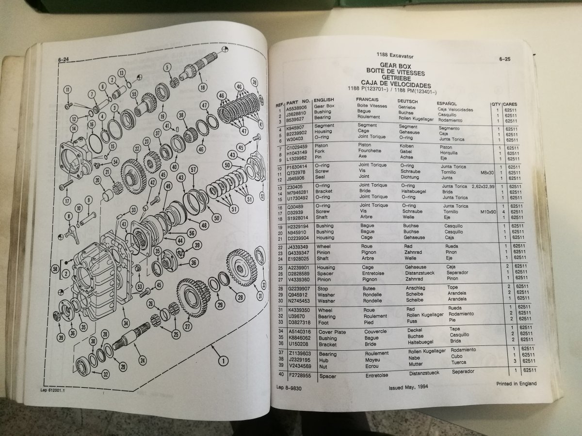

any pix? what make of transmission is it, fitted to that Case ...... see you've posed this same Q in HEF ... any luck there ?
ROAMER

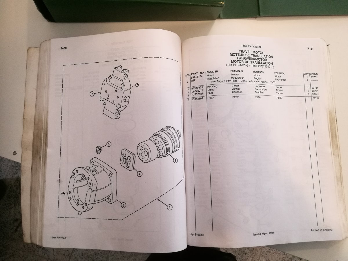

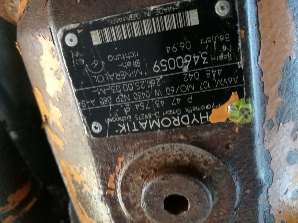

Hi, don't know what make of the gearbox is,couldn't find the plate. Case part number is A5538906. Motor is E4743754.
ROAMER

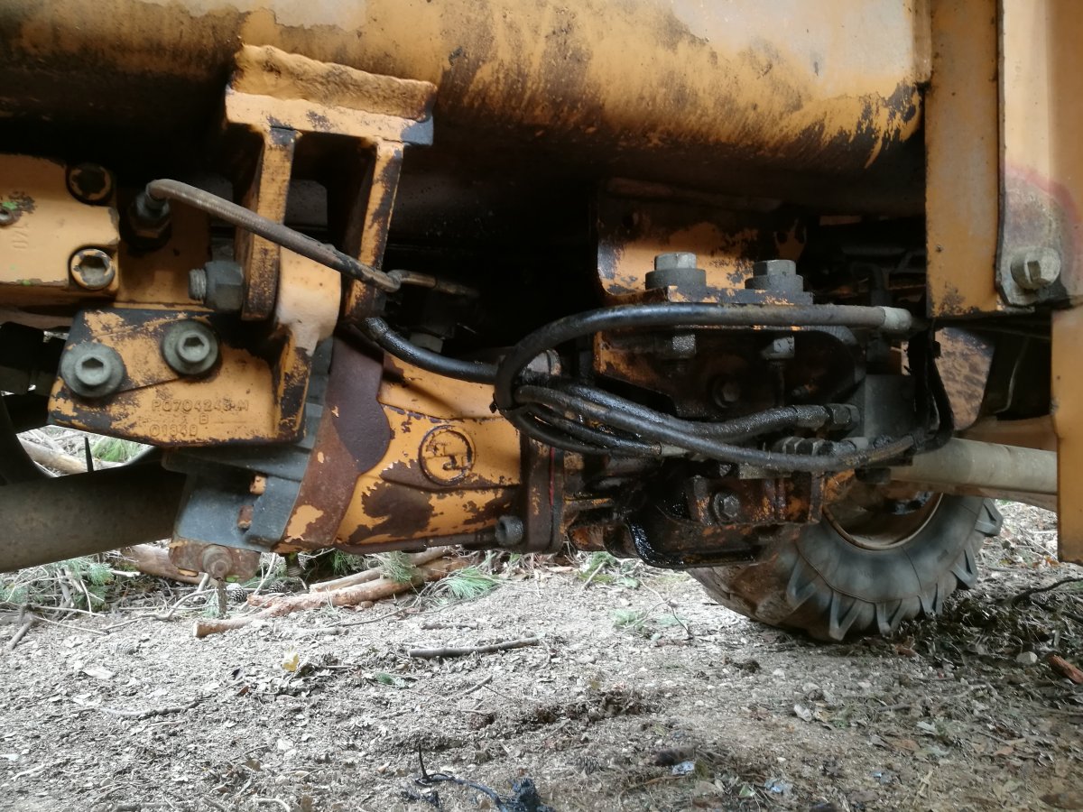

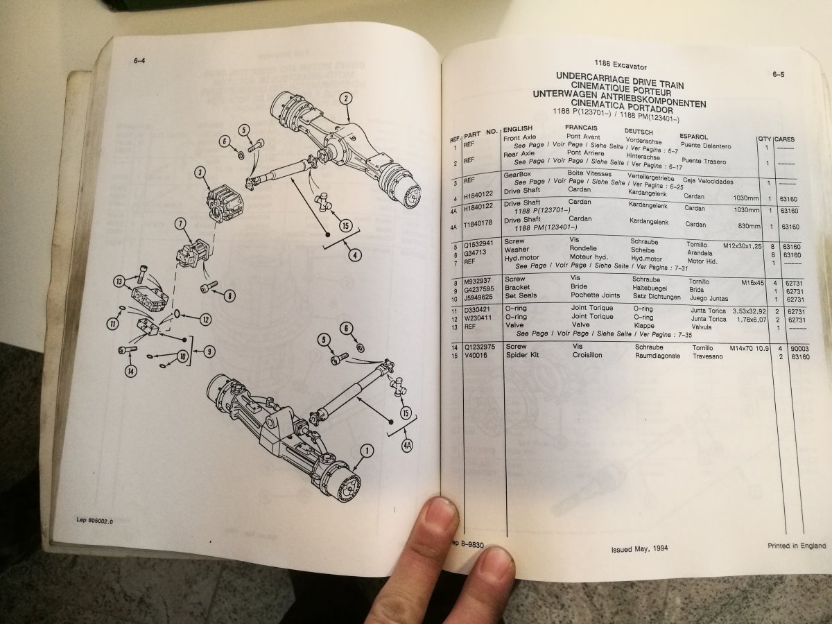

Here is some pics as well. Didn't take any detailed ones. But can do if required. Plate is from the motor.

Make sure the case drain on the motor is not blocked, but could be the hi low speed valve like you said 🤔
ROAMER
Well that's the thing. I don't want to send motor for a rebuilt if it's not it. But good point on the case drain. I might put the hose in the bucket and see what happens. Don't know how to test other actuators for leaks tough.
