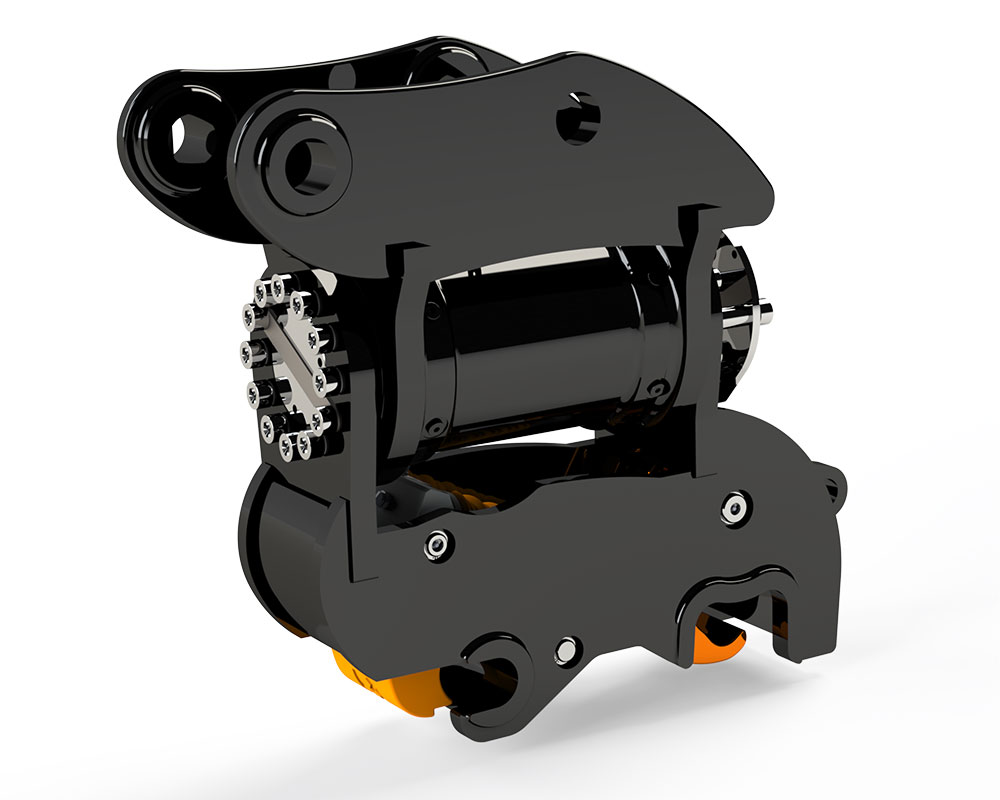

got any pix @sabre10 ?... is the tefra a full tilt-rotator or just a helical tilt hitch .... can't recall having seen a full Tefra tilty
@doobin used to run a thumb with a tilt hitch IIRC

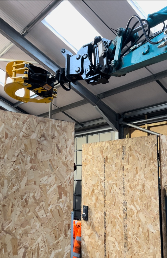

Sorry - not much of a photographer - only got this picture before the grab was piped - my hitch is as your picture - and we have modded/ welded the kelfri grab to make it rigid - as off the shelf it was designed to dangle and load timber onto a trailer - now we have adapted it - its great, and a real efficient (and cheap) competant tool.............yes you're probably right - re the rope idea...............

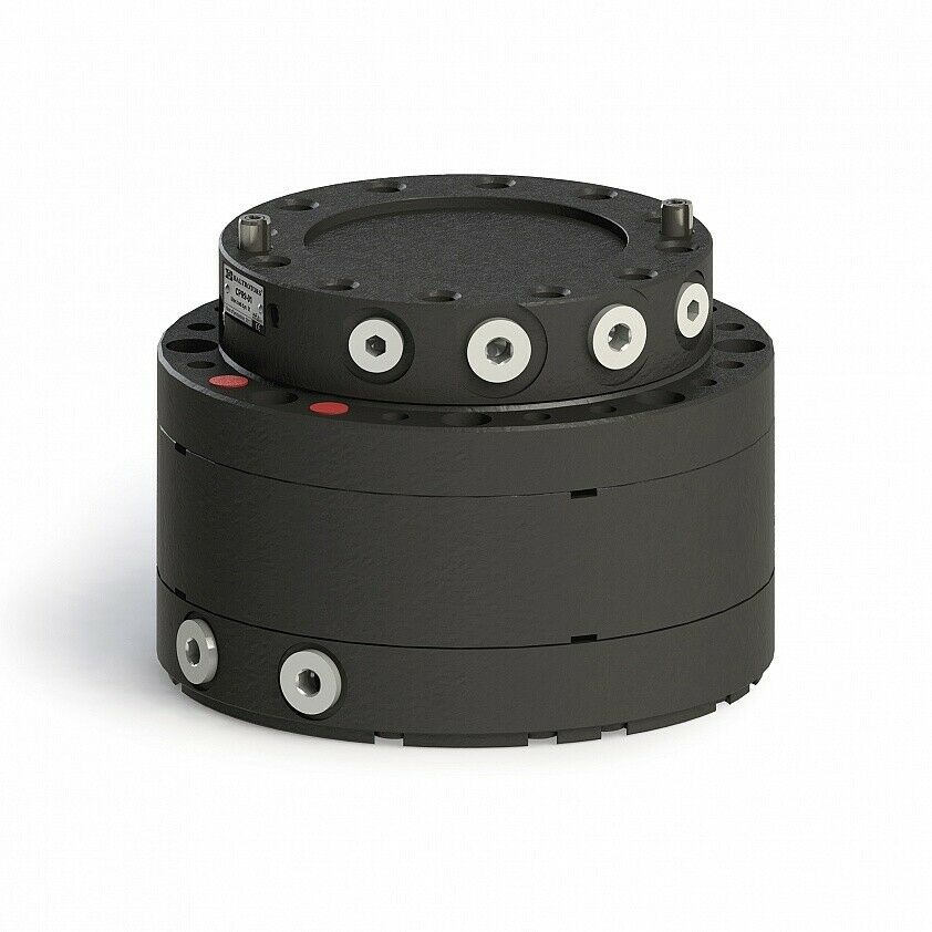

looking at your pic I'm guessing that you've 'fixed' a free swinging rotator ...... be very VERY careful putting any side loading onto that ...... they are not designed for any side loading - vertical only ... a fixed rotator is very different and much more solidly built to deal with side loads ...
that'll come apart pretty easily with not a lot of grief ...
not a lot holding them together once you start twisting 'em about and tugging at them :(:oops:
was a good vid. example of a rotator failing on a duck in IIRC Germany a while back at height ... rotator came apart in spectacular fashion ... can't find the vid ATM

Thank you for your advise V8 Druid - I agree with you completely - We would never use the tilt when we use the grab - additionally we also removed the free swinging section completely when we made the conversion and we only use the grab for moving small brash - which it handles with ease, we also understand the limitations of our Tilt Hitch - of which we use for ditching and bank work only - we do not abuse our tools or machines - If we were working with larger cord we would use a larger machine. Doobin - please read the above - we are not endangering anyone - but again thank you for your concern.

You misunderstood us both mate. It’s the rotator that will snap, not the free swinging bit or the tilt hitch.

agree with Doob ... it's not the helical tilt hitch you need to worry about ... it's the rotator that will fail - spectacularly - if side loaded ..... their strength is in the vertical plane only, basically free hanging ... it's on borrowed time fixed and unable to move/give to the loads exerted upon it
they are more of a pain to use dangling, but will last a hell of a lot longer used as they are designed to be used

have you got any better pix of what you've done to the rotator body to fix it?

Hi Doobin, I did understood - the grab rotator so far has done a fair amount of work and has not failed me yet (as I said I do not abuse it or overload it) - for your peace of mind there is never anyone near the machine when its in use as I work in private woodlands - so I am endangering no one. Its tougher than you think :) if it does fail I will bolt another one on or maybe upgrade the whole grab at that point................. this last year I've spent a lot on various tools and only a limited amount in the pot.....I like the look of your Intermacatto btw - when the moneys there I will invest in one(y)
