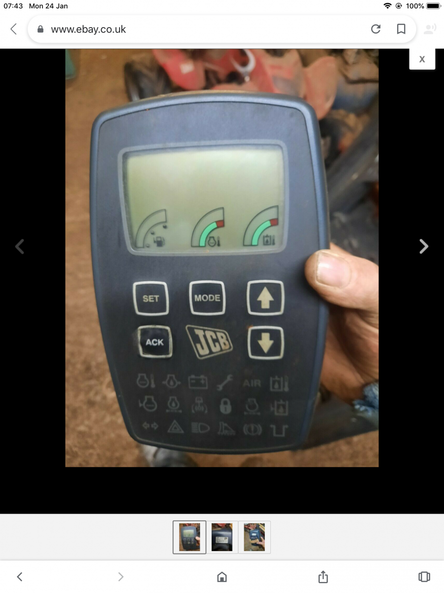

On an 8080 can you send pics of screen and buttons, include throttle dial 👍

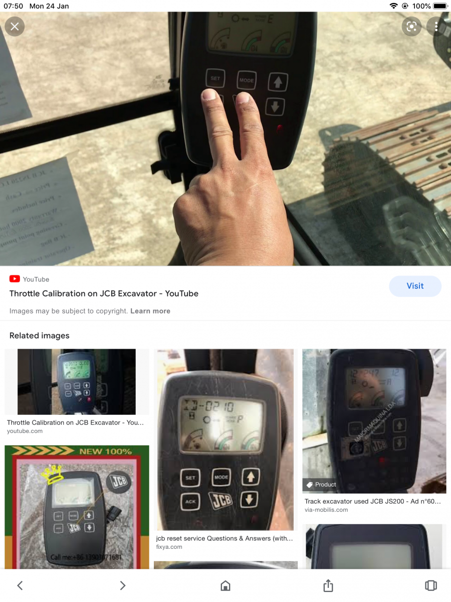

I am no longer working am retired now, there was a sequence on which buttons to press and the order to do it once that was started the throttle was put in lowest position then I think ack button pressed then a screen prompt full full throttle position and ack again and that was basically it. The machine had the older type console I think a 2004 machine. It did make the machine rev more and would also boost the revs if tracking. It made the digger much better to operate and at a better speed if needed, I guess it would also work on older js machines with the same type console. I will try finding a pic online as I don’t think I took any back then.

This was console type and a YouTube clip of calibration if it helps.
