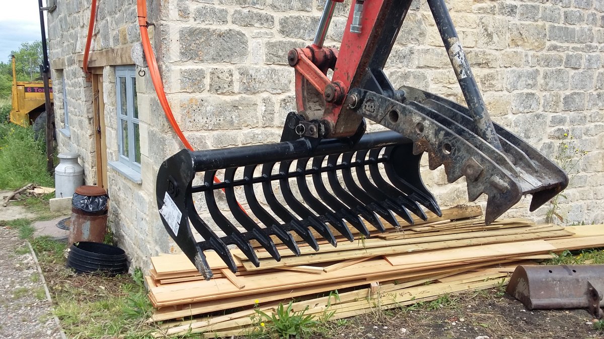

Big fan of the Scandi style buckets here. I also have this very useful bucket. 06387974-4B63-4334-9C0F-0CA71CF52721.jpeg
And one of my favourites is this device

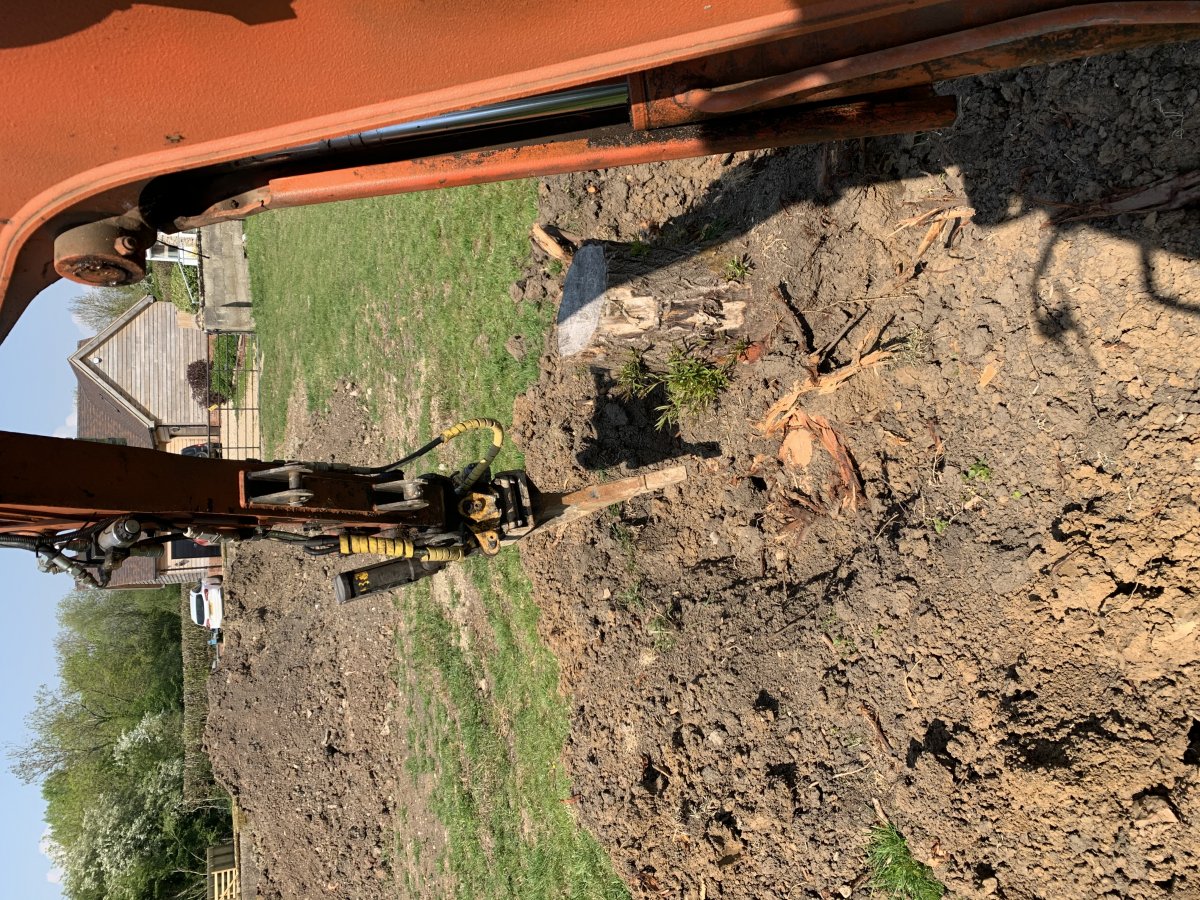

I’m amazed how much I use my ripper tooth.its makes life so easy pulling up tree trunks and pulling up really compacted ground
Nick...
I would say a ripper tooth should be in any set of buckets once you have had one you use it all the time I would use mine most days for something
