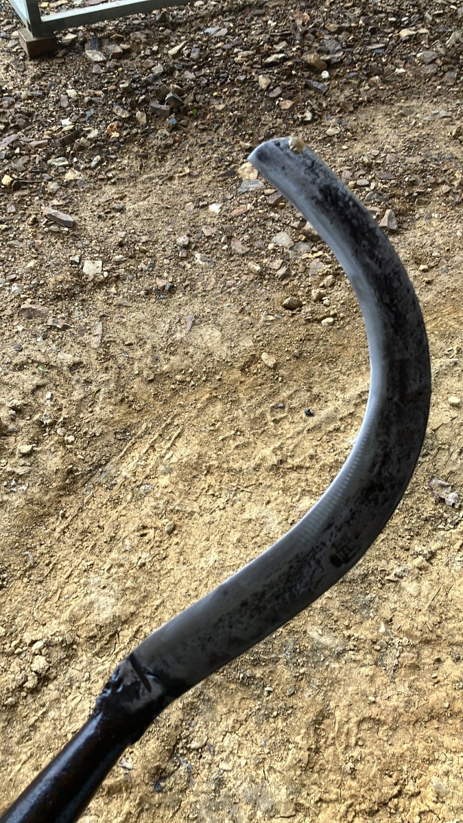

Something I have wanted for 25 years and never justified to myself is a decent brush cutter. Just spent 2 hours smashing back thistles with a sharp hook and am knackered. Toying with treating myself to a decent tool. Don’t want cheap shite and don’t want cordless!
My little Sthil FS40? Trimmer has been amazingly reliable so possibly thinking of Sthil FS again. Won’t be huge use so probably 2 stroke makes more sense ?
Brambles docks and thistles and grass and some twiggy stuff…
Who’s got any pointers.
Thanks

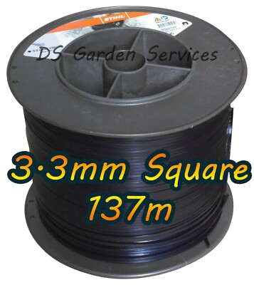

the other thing I would highly recommend is Stihl's 3.3mm square black cord -- have tried all sorts and this is the best by miles - it is awesome stuff
