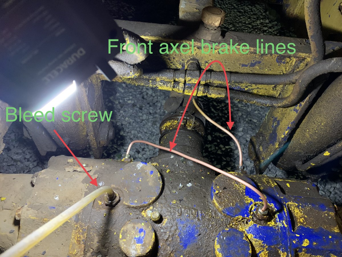

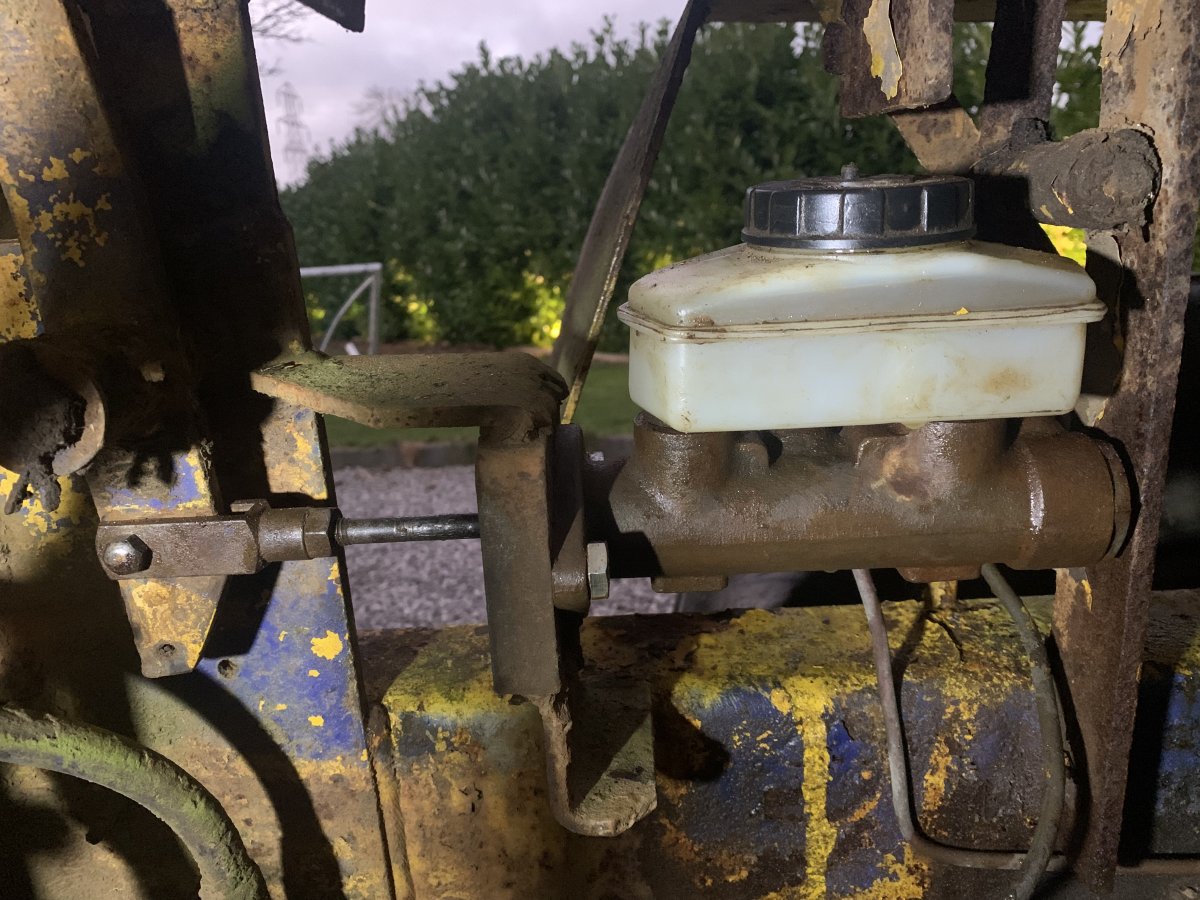

Afternoon all .. so I’ve ordered all the bits I need to stand me a good chance of getting these brakes working. New Master cylinder, bleed pressuring kit. There is a bleed nipple on the front axel of this dumper but I can’t seem to find one on the rear axel which sits directly under the engine. I’ve been under there with a light and can’t see or even feel one. The access is shocking. Should it have one ? If so how would you get to ? … it’s not even visible. Anyone any experience with this 👍👍👍👍
That's where I was heading when I asked if the level wasn't dropping.
If the peddle is going down repeatedly, but the level isn't dropping, the fluid must be returning the the reservoir.
If the level is dropping, but you can't find the leak, it'll be draining into the axle.
doesn't it have the same axle both ends????? .... 't is frame steer isn't it ? :unsure:
Yeah it’s a frame steer and has similar if not the same axels each end. Its got to have a bleed point I suppose. I’ll delve deeper tomorrow. Thanks again for the help 👍👍👍👌
