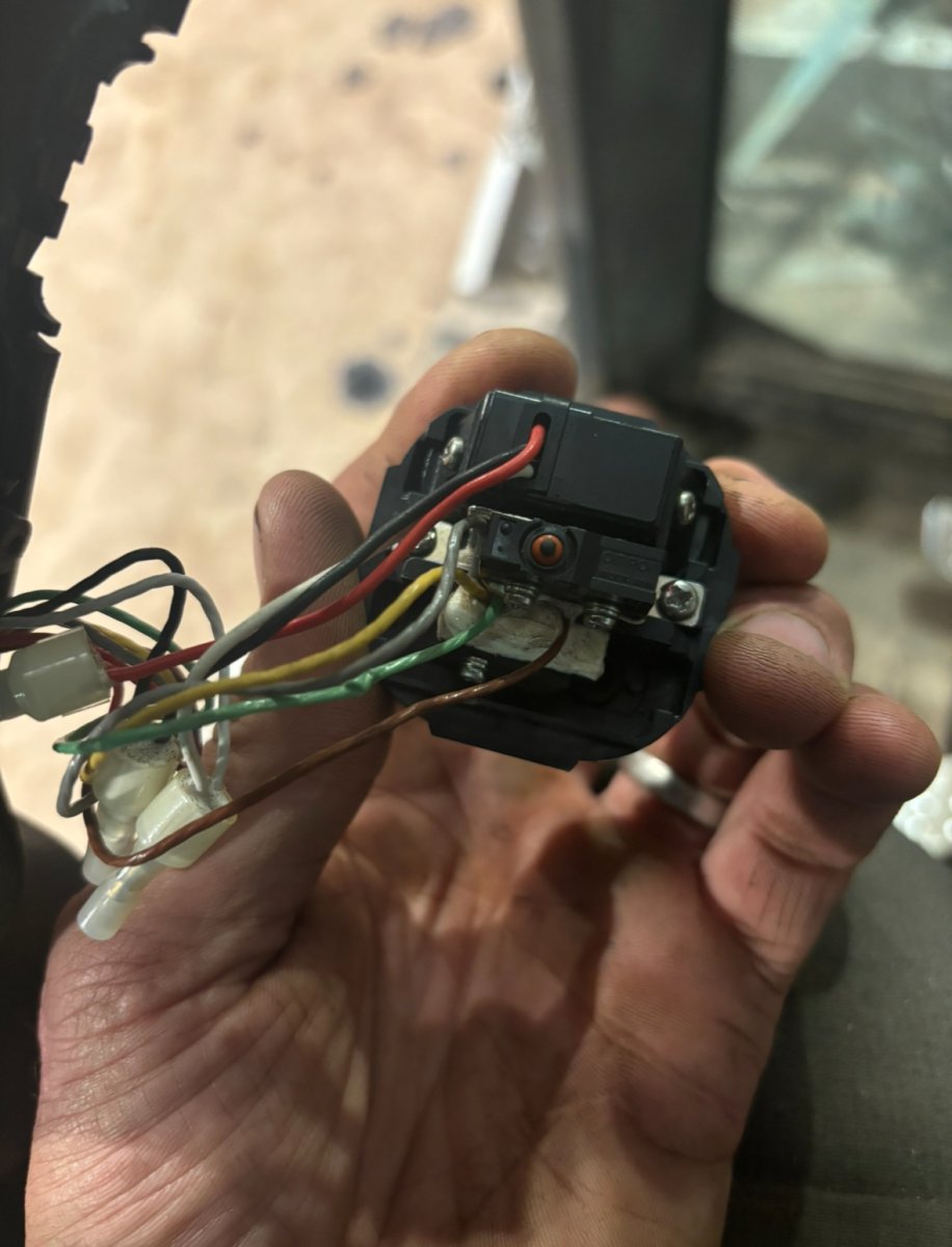

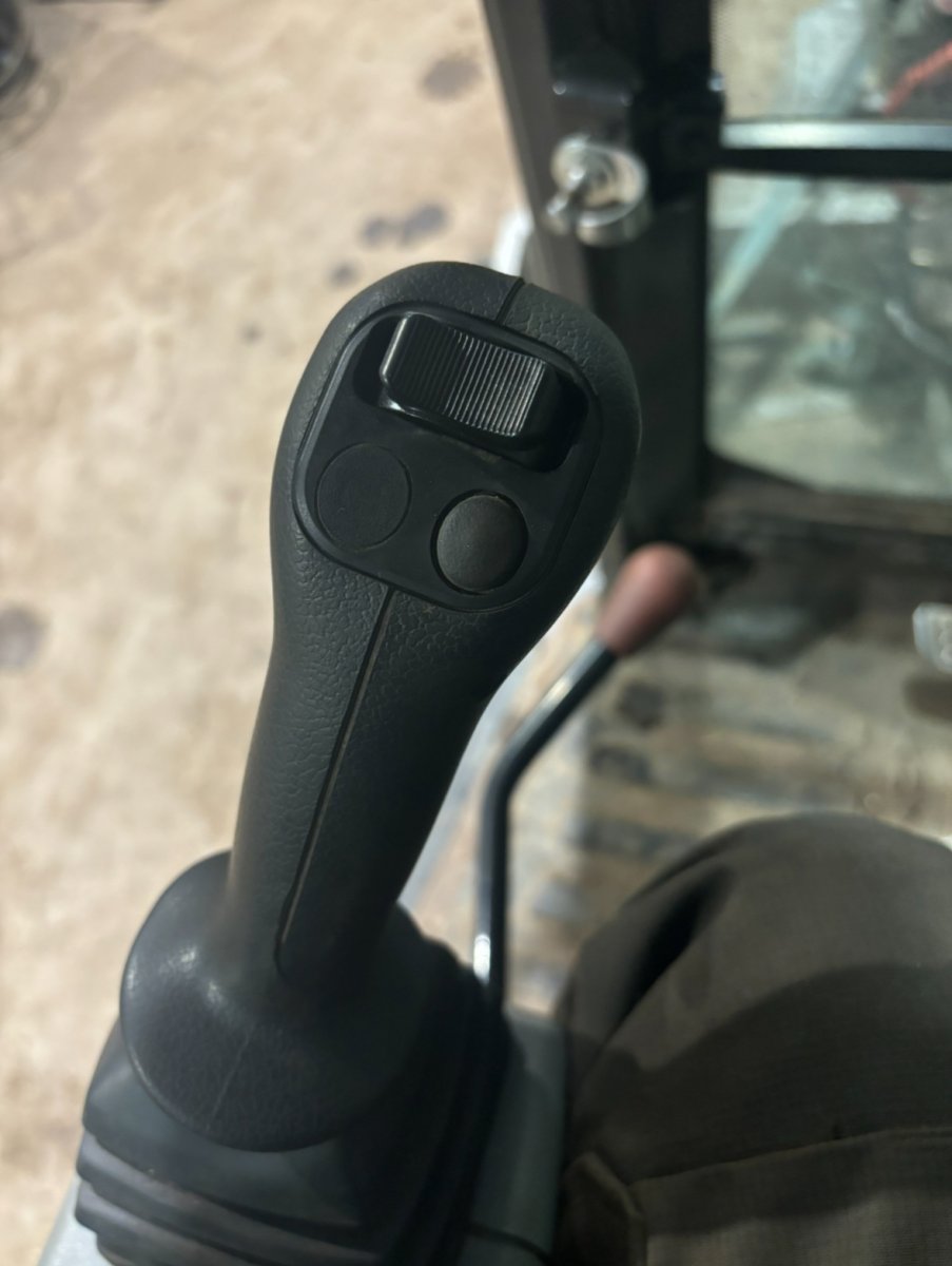

Does anyone know where I could source a proportional thumb-rocker switch for my Bobcat E27 left joystick? Bobcunt only sell the complete joystick assembly with pilot valve for £580ish or just the joystick with switches (no valve) for £1200ish (genuinely!!!).

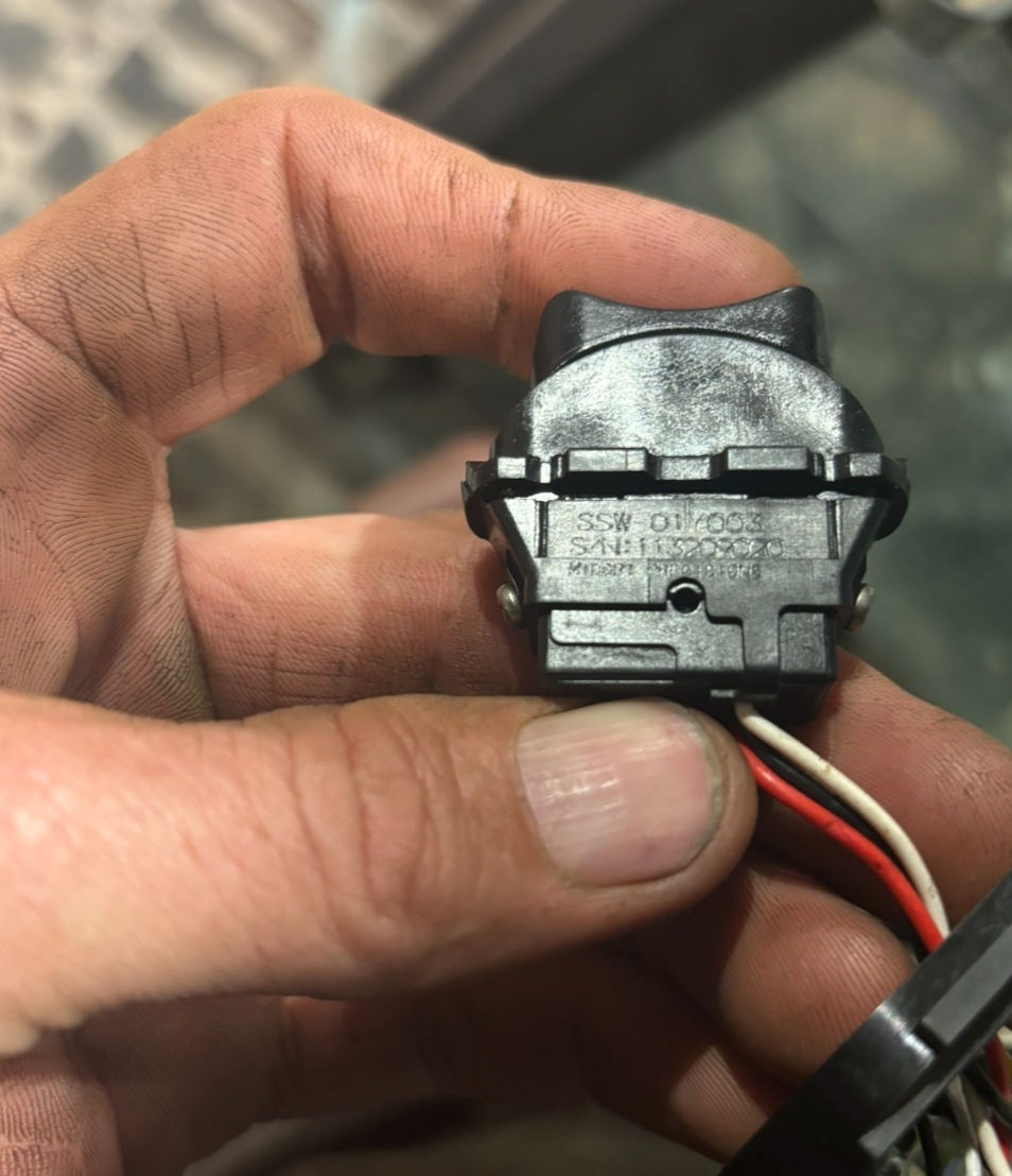

I’m sure this rocker is fitted to other stuff. It’s made by Midori Precisions, has SSW-01Y003 and S/N 113209020 etched into it, has 3 wires coming out, and doesn’t seem to work (the digger keeps throwing up M6022 fault code and that rocker stops working).

First things first- swap the rocker over from the other side to make sure that’s the problem? The code is ‘switch out of range’ but I’d say there’s a chance some dodgy wiring could also cause it. They are very voltage sensitive, wouldn’t take much of an earth leak through a corroded coupler to throw it off.

Yeah, before I chuck any money at the job I’ll swap them across, CBA to strip the dash tonight though.
