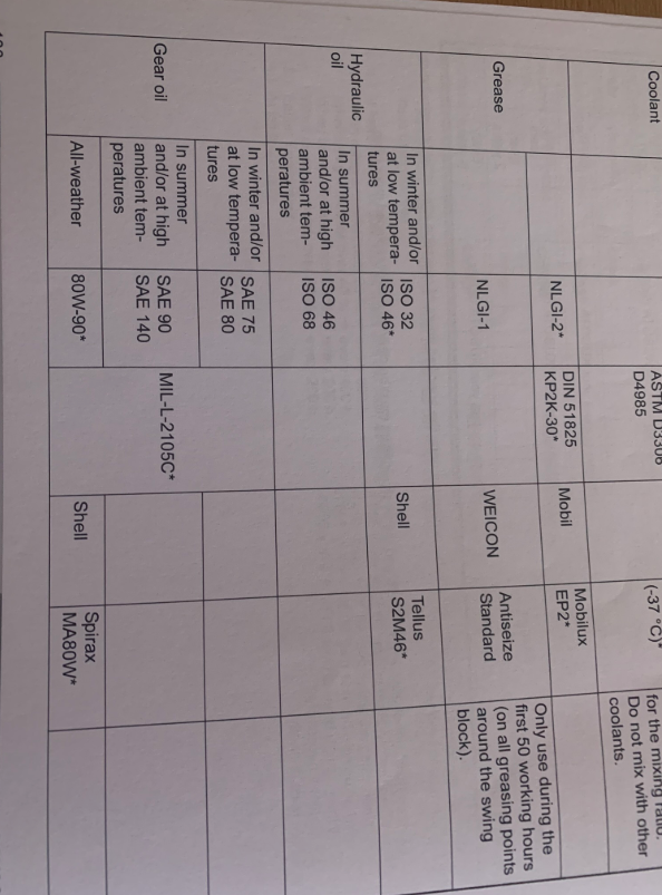

Just a quick one, seen as the maintenance book covers everything but what i need......what oil is going in the track motors of a bobcat e10.
The jcb micro has sae 30 oil in, but dont want to put that in the e10 if its not right.
I've always used 80/90 in track motors. Unless I hear different here, that's what'll be going in mine.
would've thought that far more appropriate for a planetary drive, than SAE 30, as that is the application it's formulated for (y) .... close meshing, heavily loaded, gear trains :unsure:
Thats what i was expecting it to be but the book didnt state which oil just the usual how to bit. 😀
Im taking the dx10 in to dealers tomorrow so ill ask and see what they say.
SAE 30 is what jcb book says and was told at dealer too so thats what it got, they couldnt argue if anything was to go wrong when it was still new. The jcb has done 2200hours and still tracks as good as day 1, and its done lots of tracking about i can tell you.😂

from the kubota mini manual
