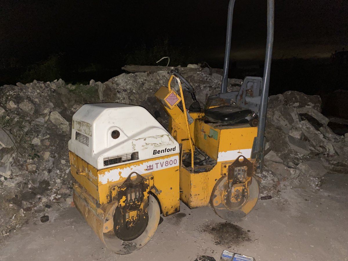

jd6820
jd6820
The only photo I got before it went back, a great runner a bit of a tidy up and it’ll be sweet as.
