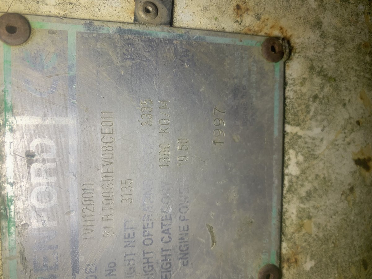

Hi I have Benford TV1200 roller it starts and drives vibrates fine the only issue is sometimes it won’t go backwards and sometimes it won’t go forwards without pushing the lever say backwards first quick then forwards so it will go forward or Vice a versa it’s like the brake gets stuck on can anyone help

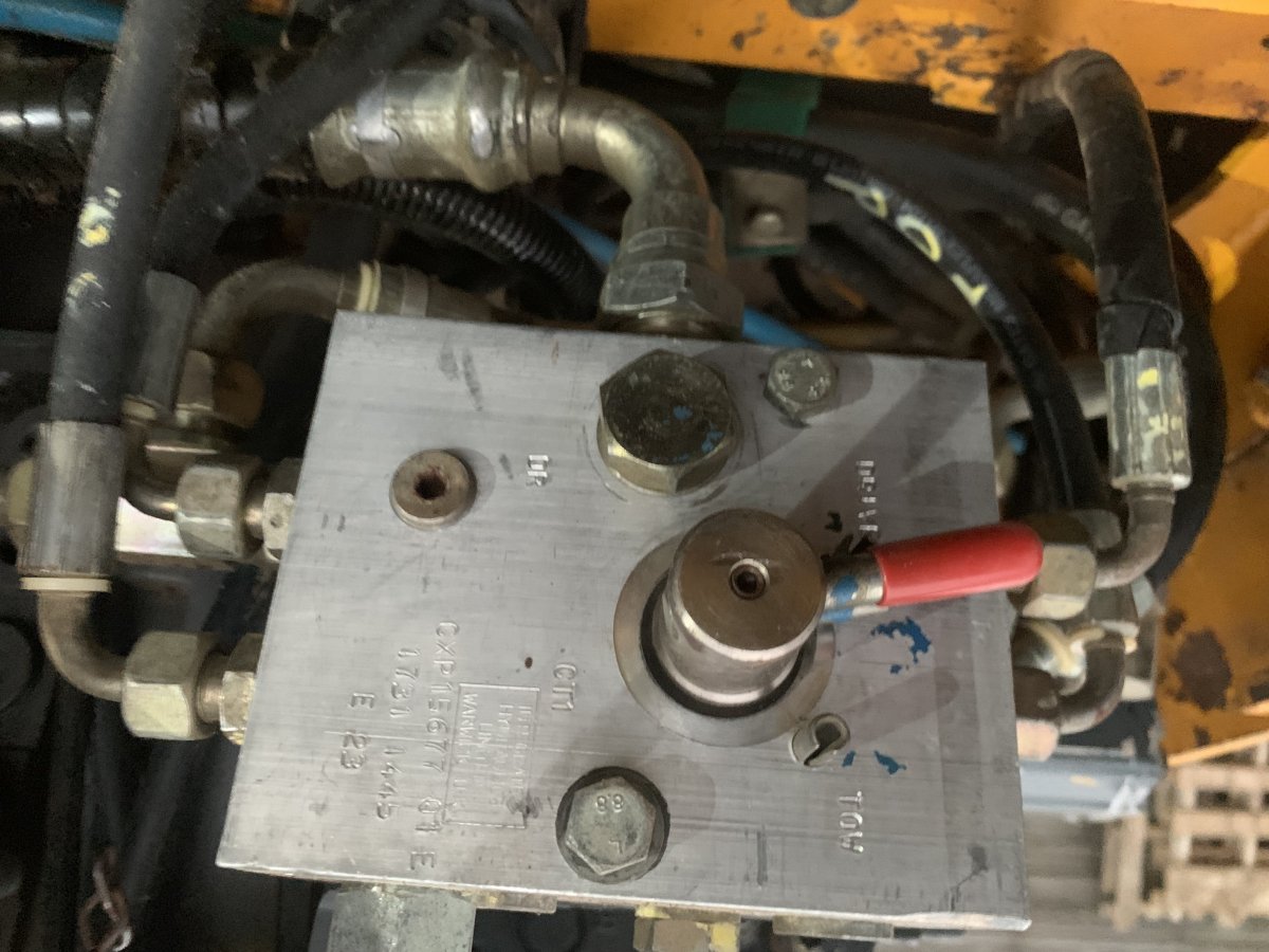

Doosan
Is this the block I’m looking for please

That looks like the free wheel valve for winching etc, you have an old model, please post more pics of the drive motors and hubs both sides.

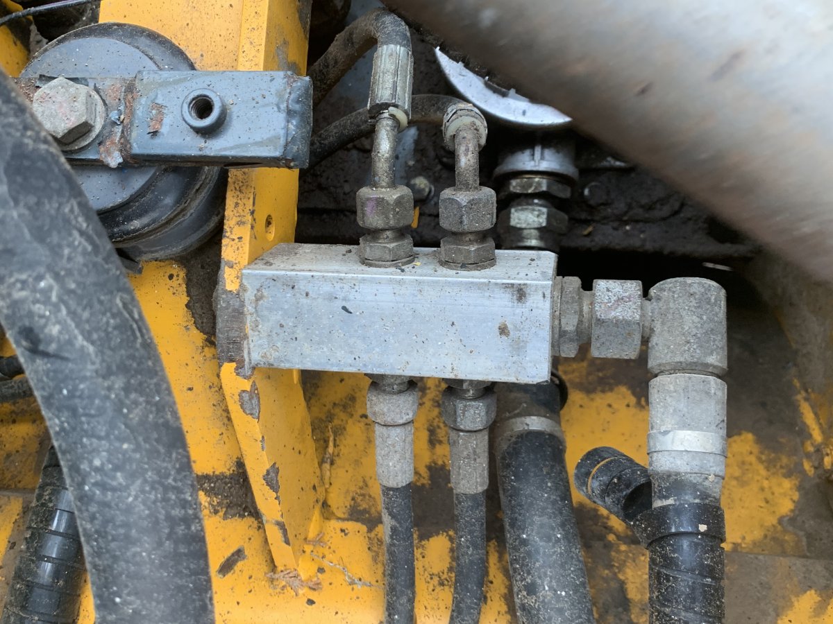

Doosan
What about this one

Yes it would be the case drain to the top of the tank, one from each motor, one from the hydroststatic pump and the tow valve, another from the steering orbital, good shout, you could always follow the hose from the brake packs back to a valve, it should have a solenoid valve operated by movement of the f/r lever.
