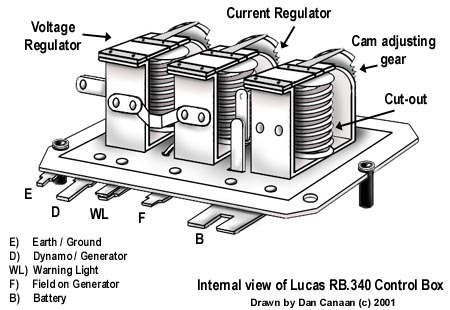

if it's the old twin/triple coil regulator .... they can be adjusted for out put ..... bound to be summat on't 'net/you tube about doing it ..... otherwise I have a write up somewhere on how ... but could take some finding :rolleyes:
as said ..... check all connections and demount the reg. box to look at the connections under it too IIRC there are some wire wound resistors under it with primitive crimp connections
twin coil
triple coil
been a while since I played with one o' they :giggle::giggle:
