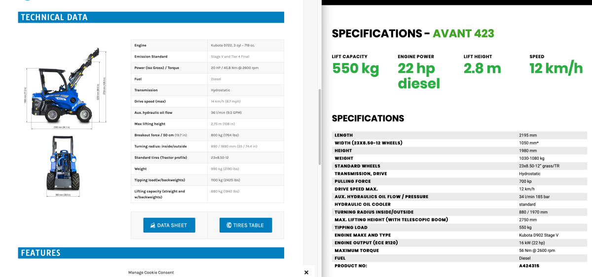

You could look at a Multione 4 series. 980mm wide, looks like you could get it narrower with different wheels. Rated lifting capacity is 880kg with backweights, and I've found their rated capacities to be pretty accurate. You're just about into bulk bag on a pallet territory then.
When you put the specs next to each other there's really not a lot in it. You will probably find the Multione quite a bit cheaper also.

On paper the Multione 4 series has 300kg more capacity lifting capacity for the same weight machine.And double the tipping weight.

I just looked at those figures, yes it seems that the Multione has a lot better capacity for more or less the same weight and size.
