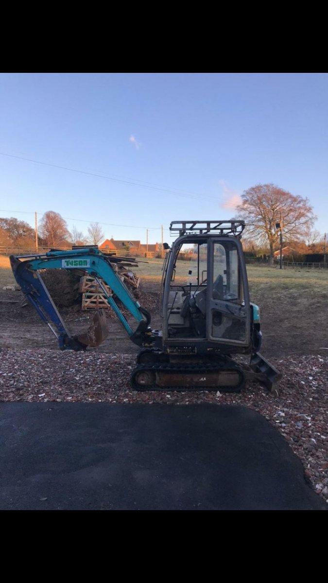

Hi all, I've recently purchased an old airman ax 22 and have changed all filters with the exception of the hydraulic filter. I cannot locate its position. Any information gratefully appreciated.

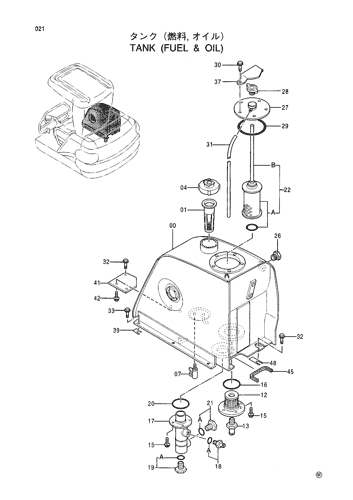

If its the same as an ex30 it will be on top of the hyd tank, where you pour the oil in

really??? that to me would be the filler strainer ......
the hyd oil filter I'd expect to find on the return line from the pump to the tank , cleaning the oil returning into the tank from the system.

Yea and theres also one under the cab floor

All my machines have the hydraulic filter ontop of the tank 👍🏼

Think he means undo the bolts on the plate that has the filler cap on take it off then pull on the long stick to lift filter out from the bottom of the tank where it sits over the return to tank
