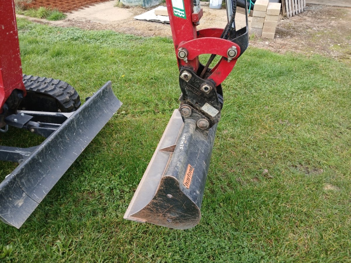

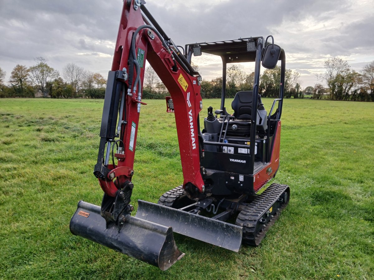

Not sure if this helps, but my SV19VT is fitted with the Uni Loc and has the Harford buckets too. Unfortunately I did not see the hitch being fitted to the machine, as they took it back to the dealers for that to be done.
The Quick hitch is the easy bit, a kit is around £400 or so and you could fit it yourself if your mechanically minded.
The foot controls are the problem, they are probably (but not definitely) linkage control to the main valve block.
If this is the case then forget trying to convert them.
If they are servo then you have options. A proportional kit to convert a foot control ro hand control is £1200 and you need 2 if you want to do rotation/offset as well.
