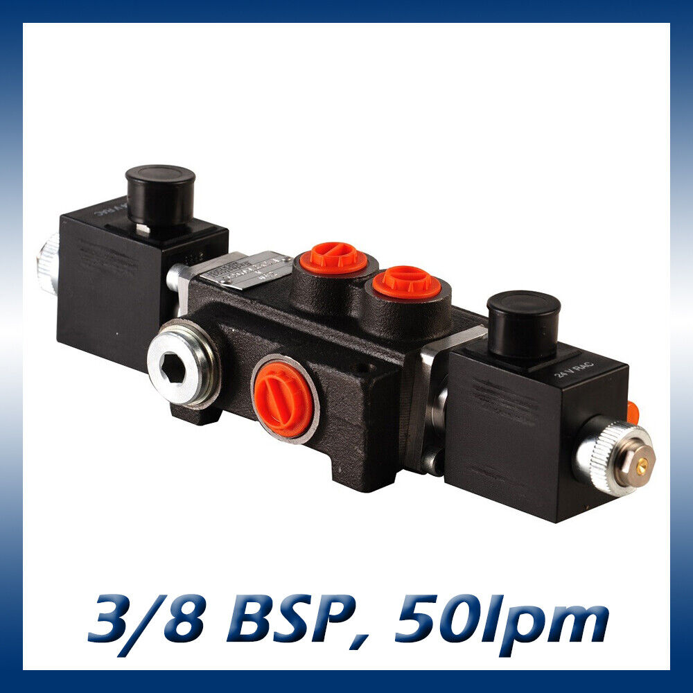

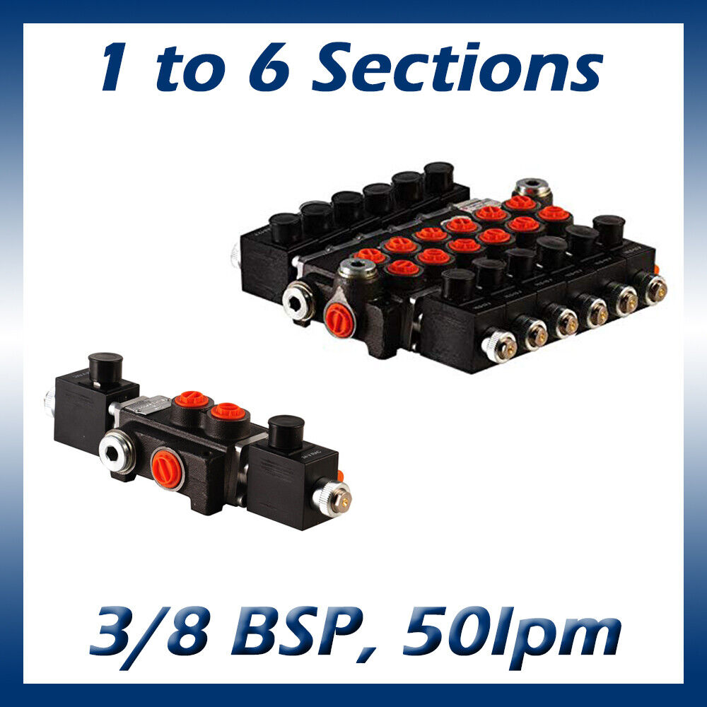

so why not a prop Cetop then Aiden ?? small single gallery manifold, prop solenoid coils and a driver unit from the roller ? :unsure: wouldn't be that big, especially if you used an integral unit, rather than the manifold/cetop block type, like these ...
dare say prop coils're available with drivers to suit

But isn't that just solenoid control and not proportional?

yeh that one is Mike .. but, as said " dare say prop coils're available with drivers to suit " :rolleyes: ...
dinky little units for the flow rate ;)
wish they'd been available when I was VA-r building :giggle:
admittedly those are nice little valves for the right application.. but not for what Doobin wants to do.
One, they are not proportional, and its not as simple as just adding proportional coils to a valve.... a proportional CETOP is different to a standard one.. the galleries' are different.
Plus if you add that into a machine you will steal flow from the rest of the machine.
It needs a proportional Pilot feeder valve, operating the machines main stool valves, driven via a proportional controller.
The tricky part is modifying the main spools for linkage to servo..... it involves machining new caps etc.

admittedly those are nice little valves for the right application.. but not for what Doobin wants to do. (y)(y)
..... a proportional CETOP is different to a standard one.. the galleries' are different. (y) (y) Plus if you add that into a machine you will steal flow from the rest of the machine.
