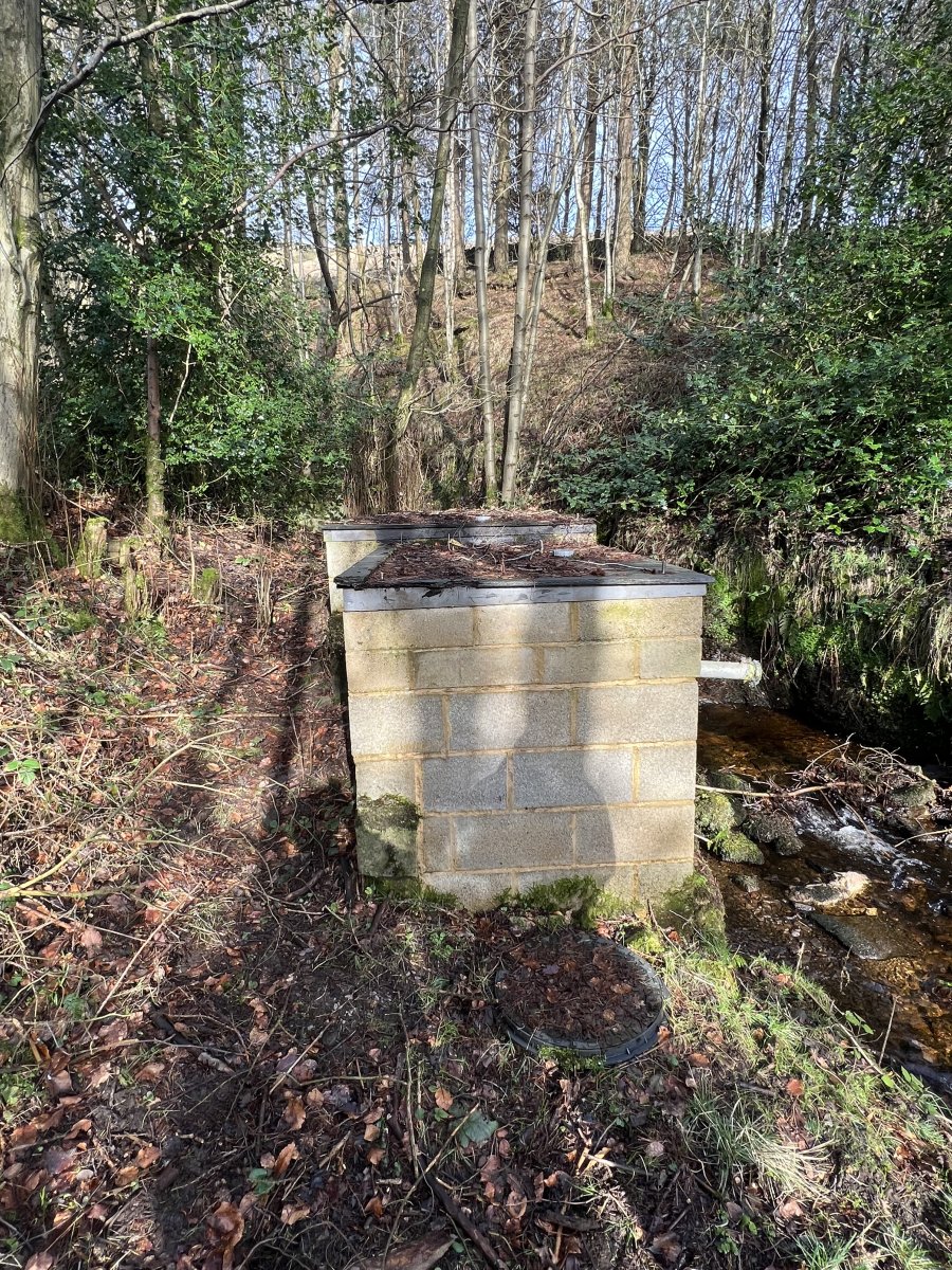

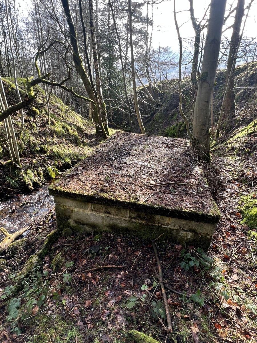

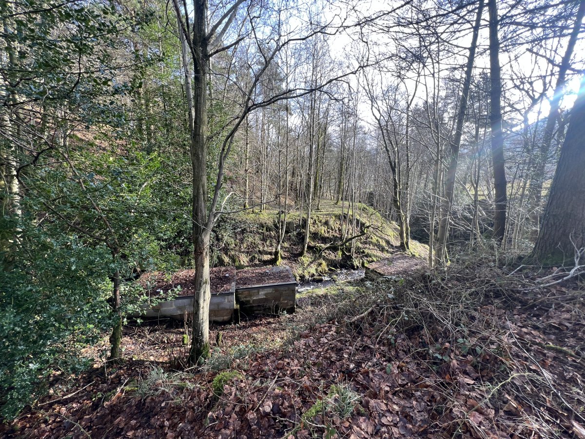

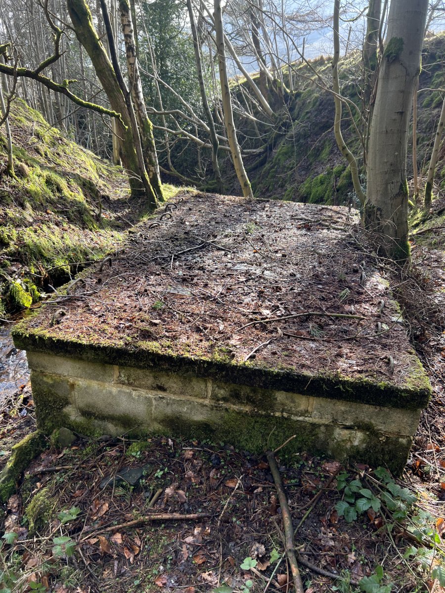

We need to reroof these tanks that gather water from a stream for a trust camping barn,
My parents spring comes into a silt trap then into a big concrete tank like a small swimming pool with a concrete roof
