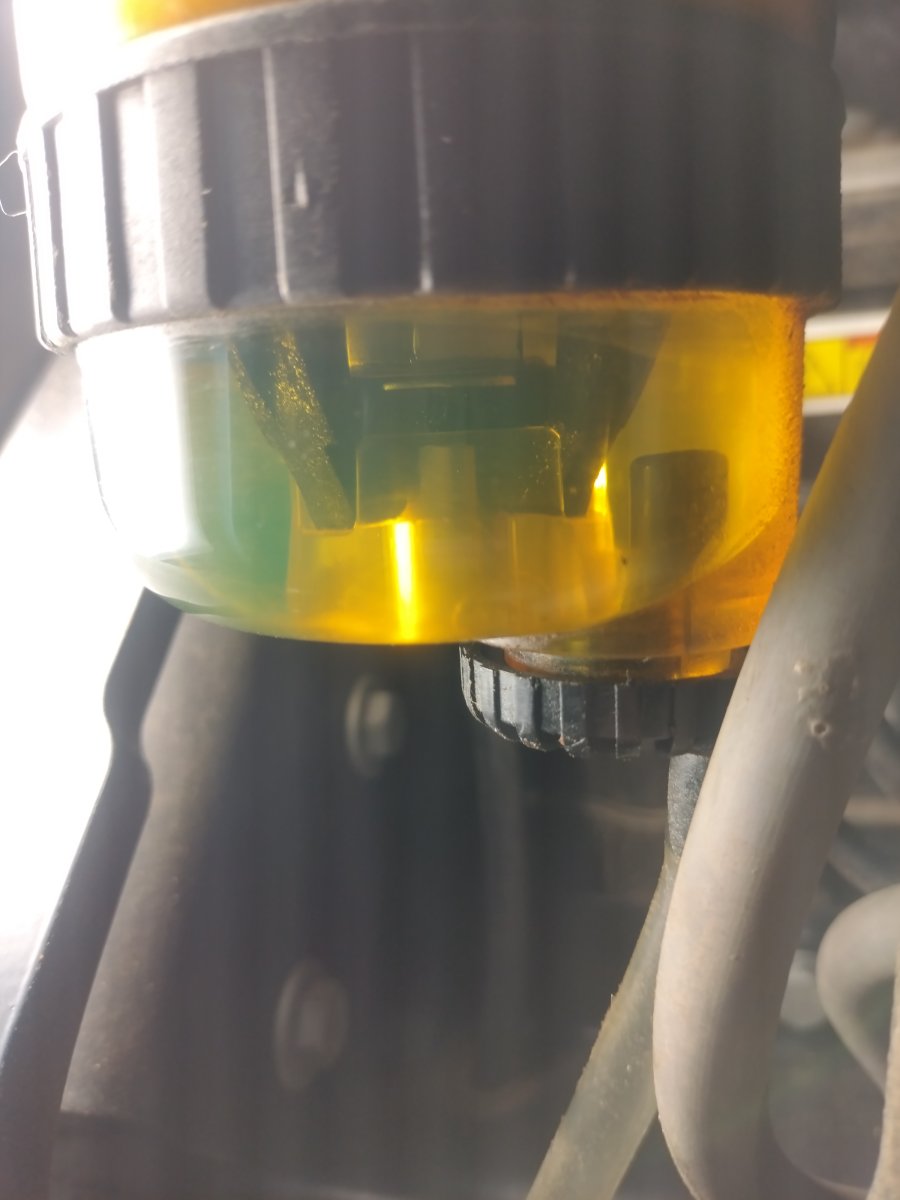

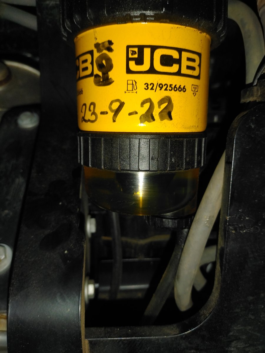

Went out with a torch and this is the water separator
There's a much smaller filter in a white plastic casing that fuel passes through before it gets to the larger cartridge one. Did you change that one when you serviced it? Also try blowing the lines back through with a mini compressor back to the tank just to make sure the fitter doesn't try to blame it on something simple which is your fault!

I seen the smaller filter, but now way to look inside.
I did say to the service guy, when he tried to say it might be a filter, that I won't be paying for it. He tried to say filter wouldn't be covered under warranty but if, it is that it must be a faulty filter that was supplied.
I can't see it being the filter, I would have thought if filter related, it would be a constant issue but its literally once in a blue moon and doesn't happen again for a while

Had it before where the filter isn’t sat in right,only ever after a jcb fitter has serviced the machine may I add!!!! , drawing air into fuel lines. Never ever had to pay for a filter under warranty and I’ve had a fair few changed as part of fault finding problems.. they even changed the whole filter housing on a machine once to try and eradicate a problem(I suspected the fitter didn’t install the filter properly , but so he wasn’t caught out said the housing was at fault!)
