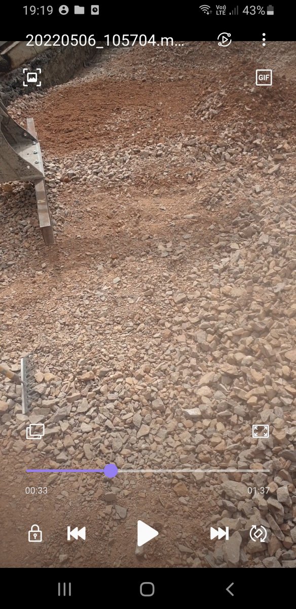

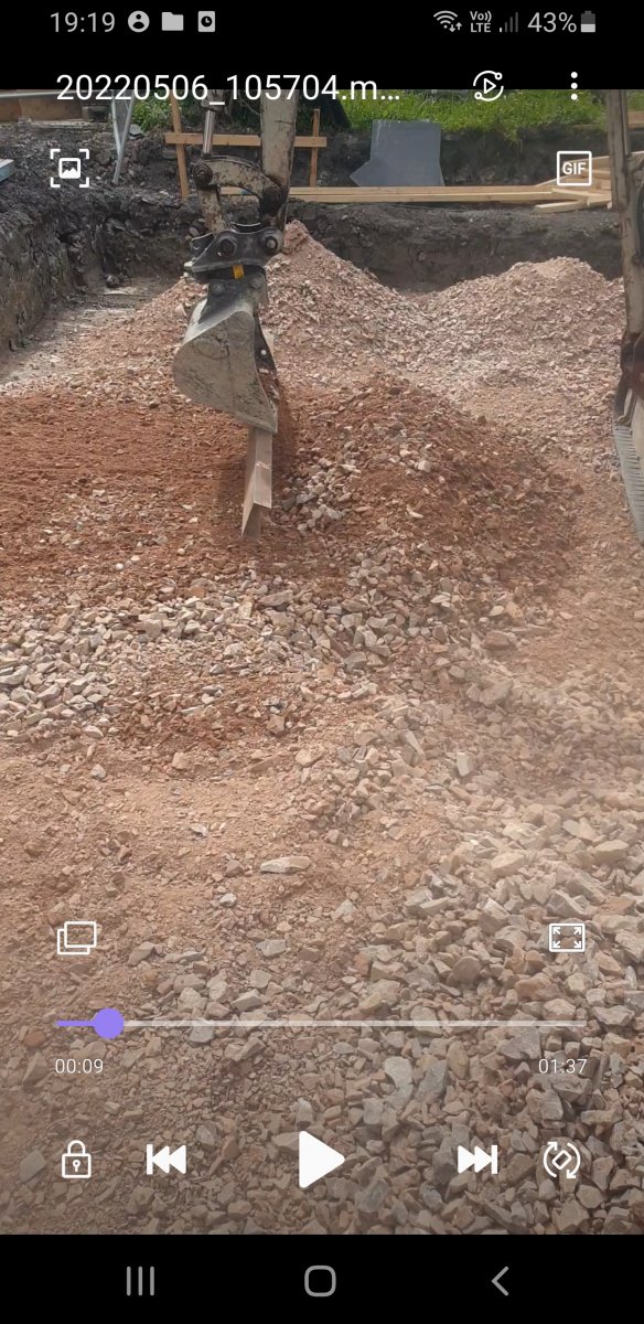

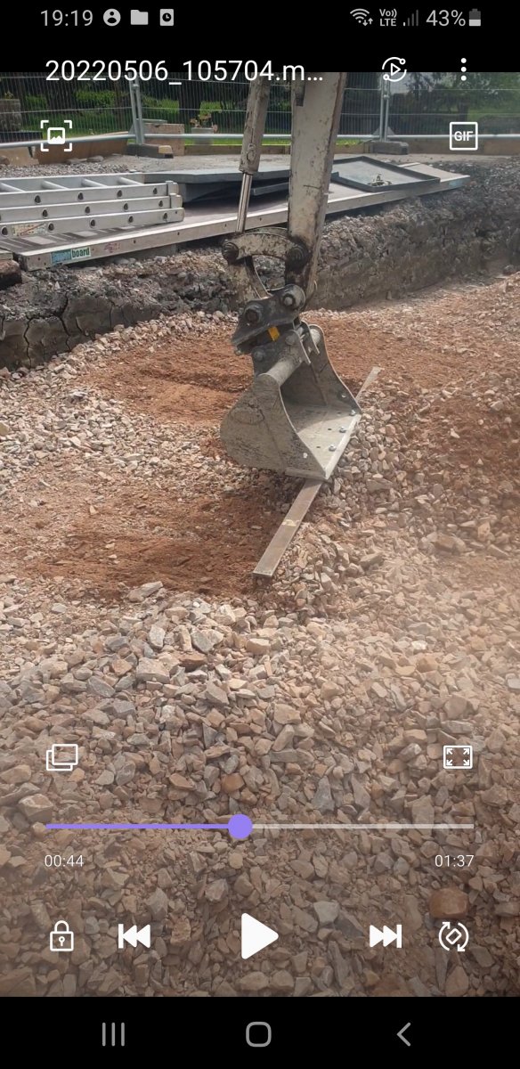

So tried the beam, the 1 i was going to use was to small a section but found another with brackets welded to it, ground them off and it worked a treat
