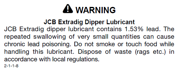

As for lube - yes, the manual lists Waxoyl (unavailable south of the equator)
Everyone seems to have an opinion as to what is in Waxoyl, but a warning in the service manual is interesting (and probably out of date)
And from the Operators Manual
