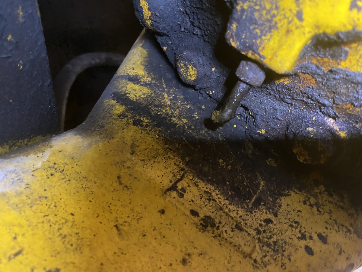

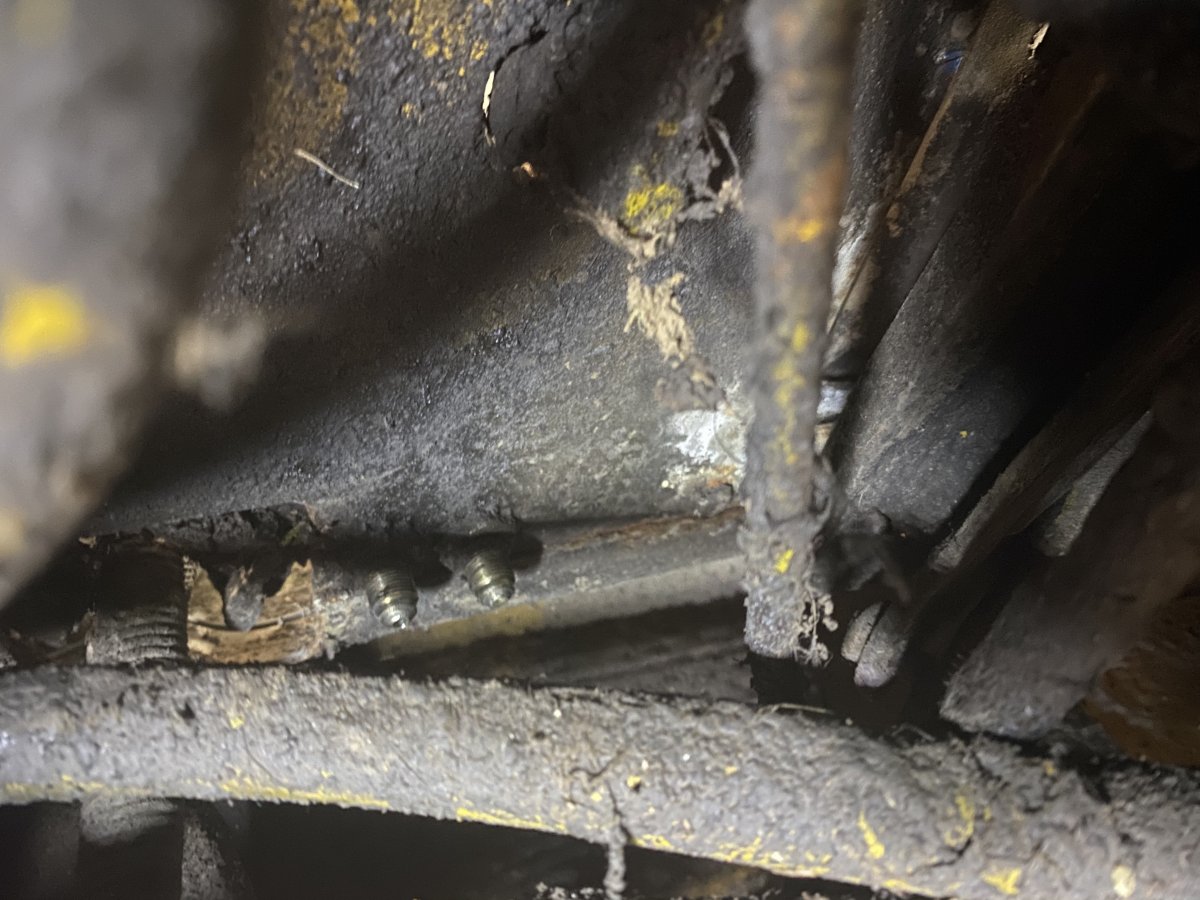

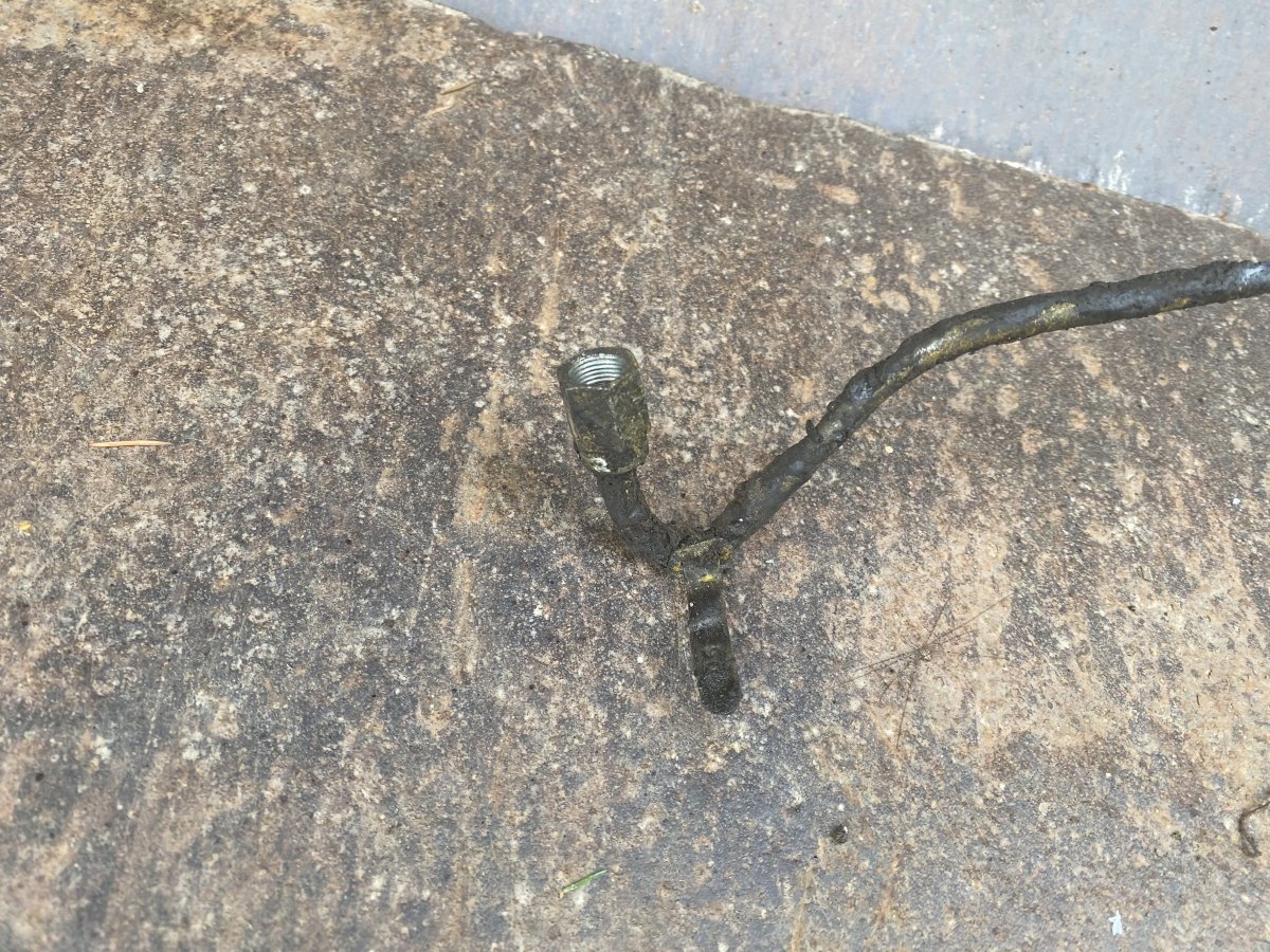

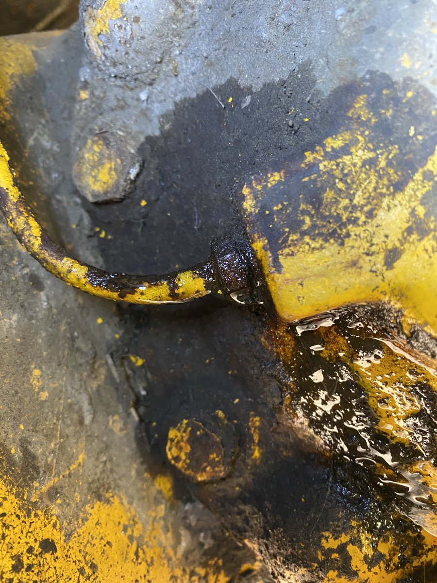

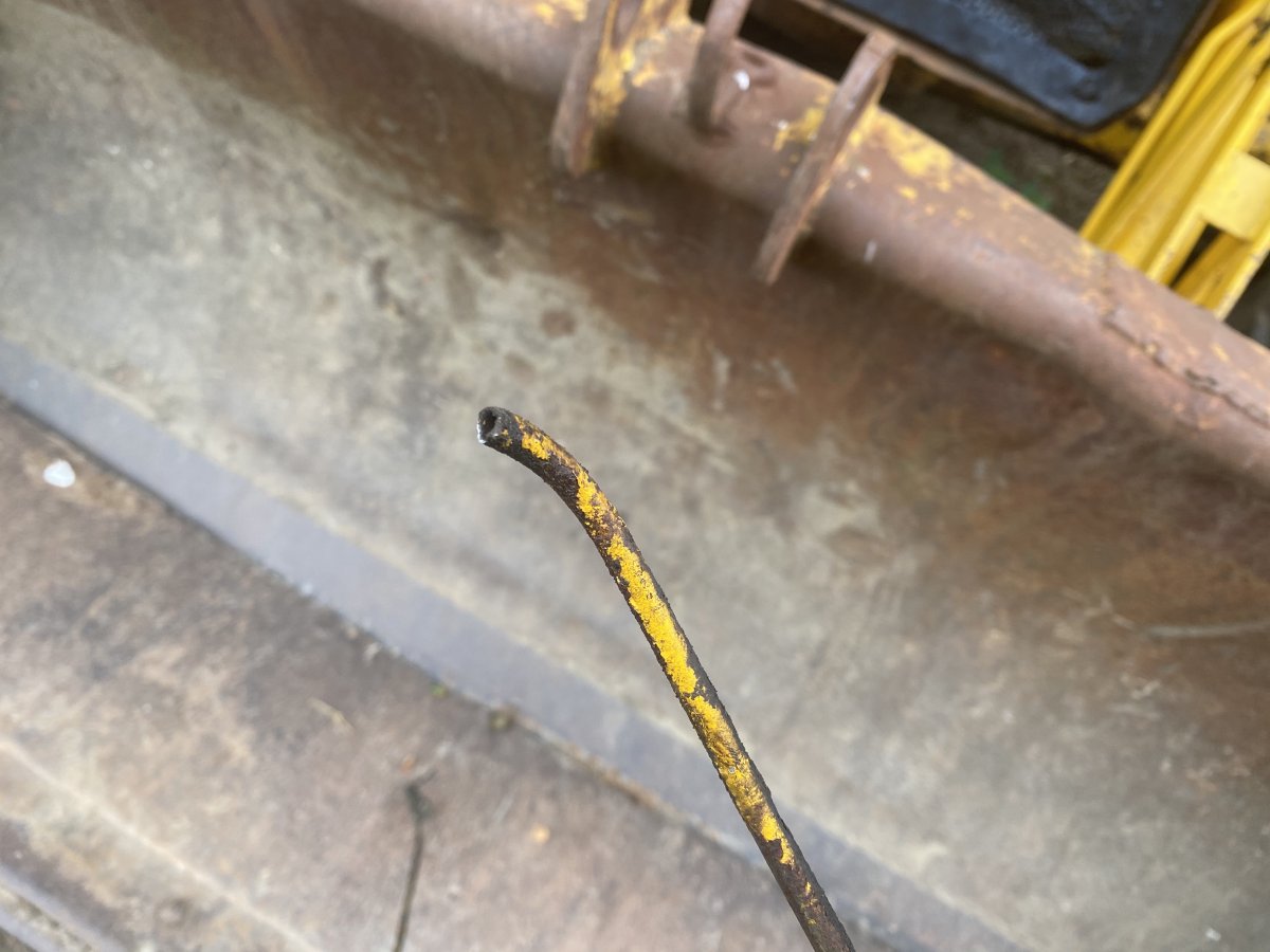

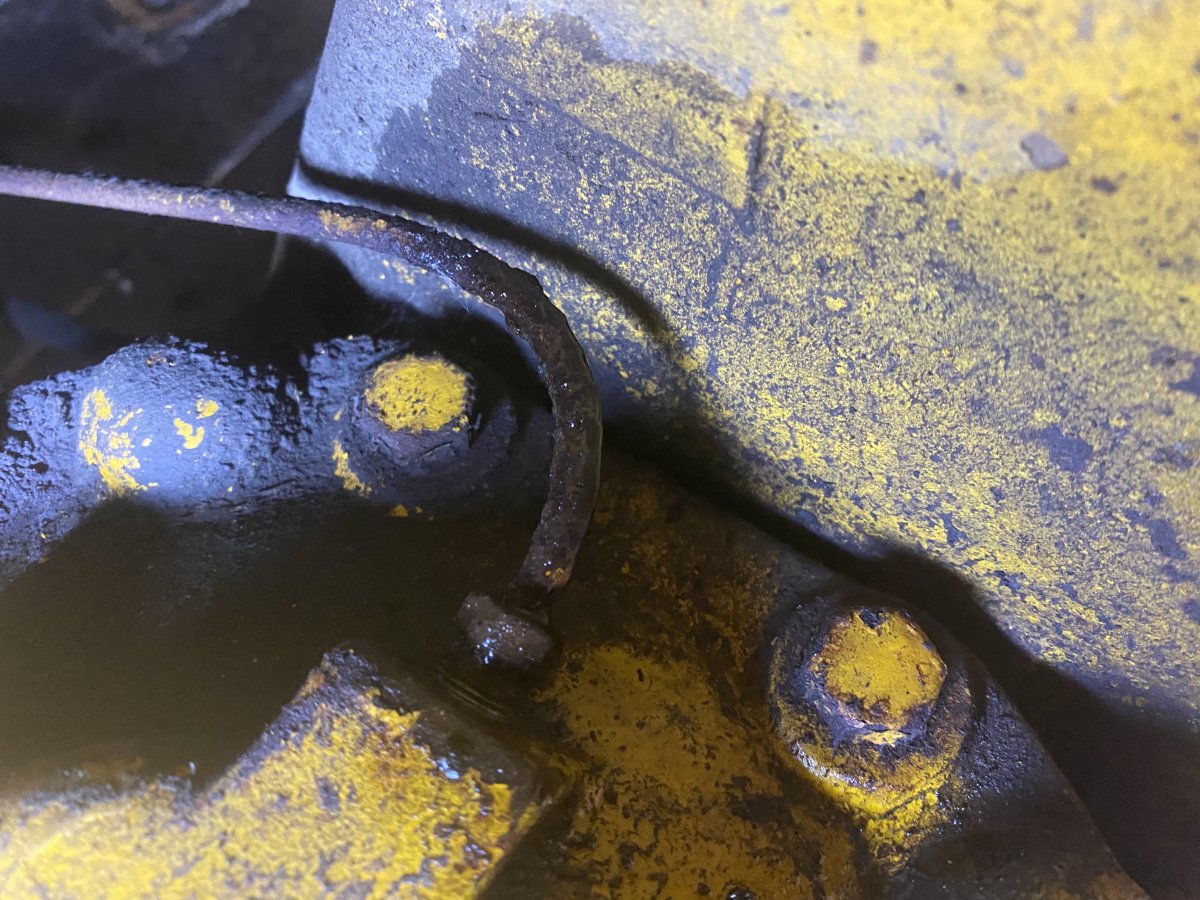

Just wondered if anyone had done it / has any advice on replacing the brake pipes on an '89 3CX Grey Cab. Realised at the weekend that I've got no brakes. Right pedal goes to the floor with no bite, left pedal will bite when pumped but fades. On closer inspection looks like the LHS has been leaking to the point where the fluid is now below the minimum - although both sides are under the minimum now so i'm guessing the right has also leaked out at an earlier time and I didn't notice as the pedals were connected.

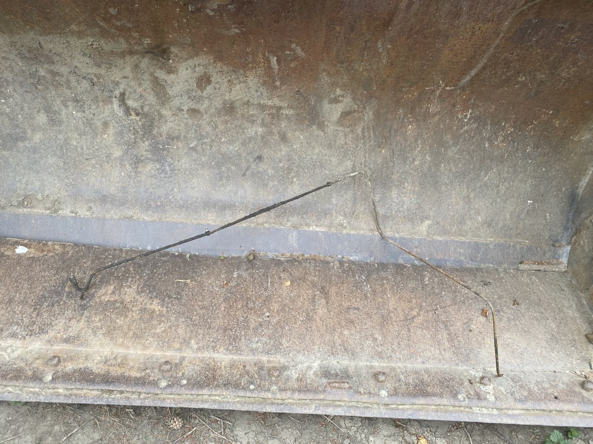

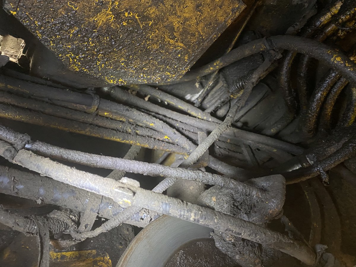

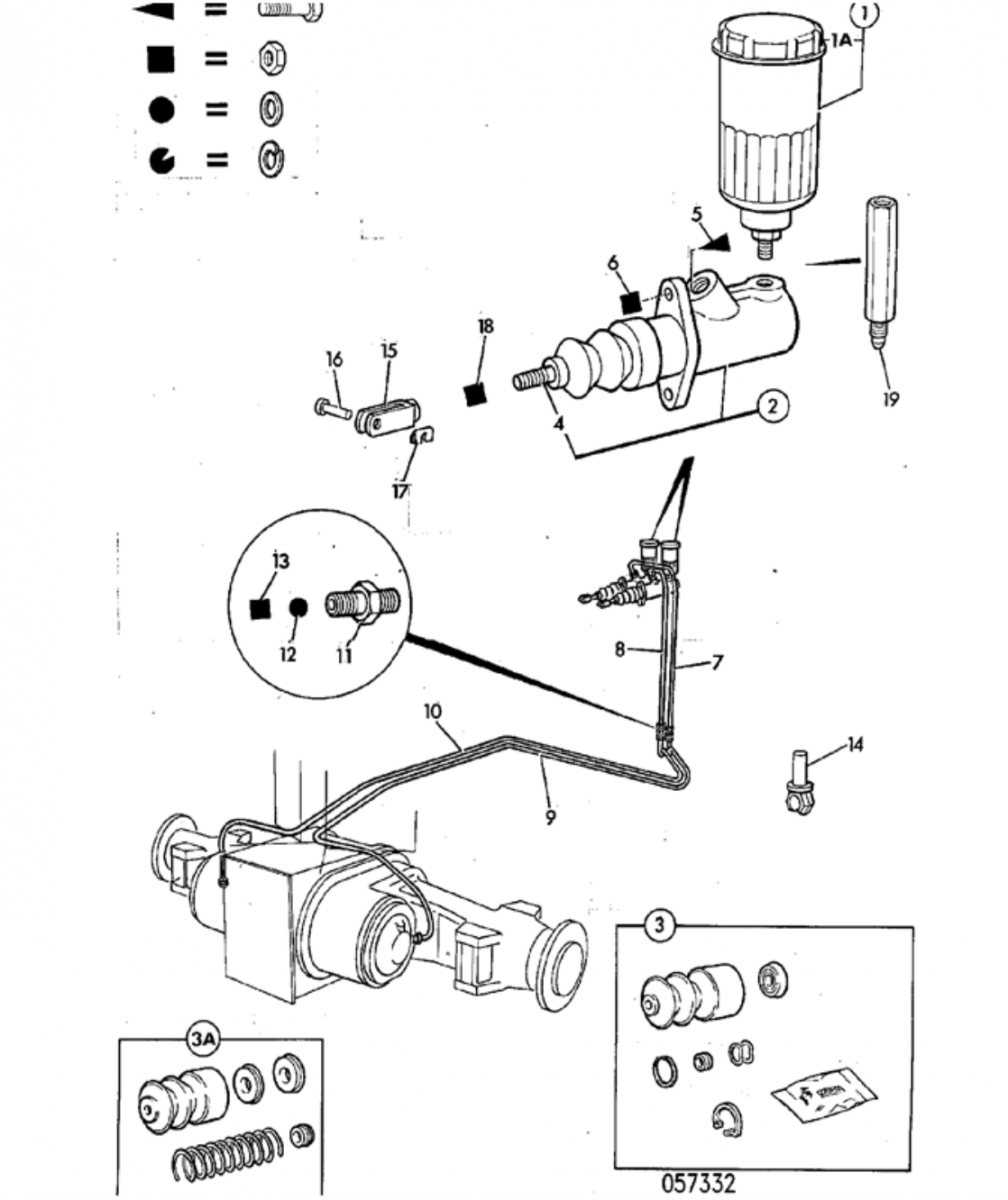

It seems straight forward enough to replace - although getting to the place where they go through the floor seems like the biggest challenge. I'm wondering whether it might be as easy to just replace the full length of pipe on both sides including the join and part inside the cab (parts 7,8,9,10,11 in the diagram). Rather than trying to unscrew the pipe from the join where it meets the floorplan
