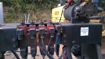

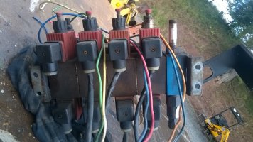

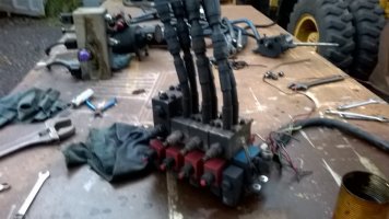

pretty reasonable for that really ...... but still a lot of money:cry: .... take it that was the servo control solenoid bank?? ...... got summat like it sat here, off Mog's de-icer :giggle:;):rolleyes::whistle::whistle::ROFLMAO::ROFLMAO:

Yeah does all safety stuff like slew lock, dead man’s handle. 8 valves and solenoids. Might not be all f***ed but fair chance if two are gone others might not be far off so short term pain but should make that bit good for another few years.
they sit in an exposed position really no cover to them maybe that contributed or just 14 years old and machines got 5k hours on it maybe unlucky
