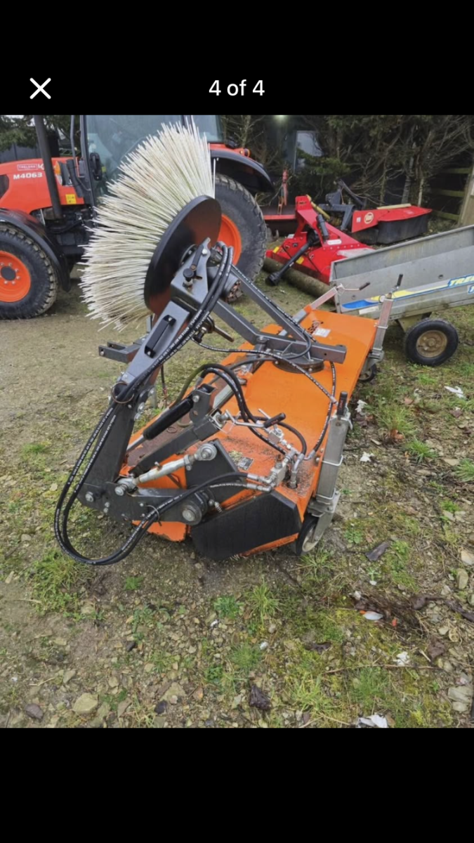

So how does this one work then?
Only on set of pipes but 3 hydraulic functions. I can see 2 x 2 way isolated so assume the side brush can be turned on and off, so you have to get out of the cab to tip the collector or are the brush and tip rams on the same circuit so that running the brush in reverse will tip the rams and running it forward closes them?
My hydraulic knowledge isn’t great. 🤔

Side brush and main run together? Pull lever for tip? Or reverse like you say.. lever may just turn off the side brush if not needed.

The ones I have used tip when you put the brush in reverse. Has a little diverter block in the system to control it all automatically.

That would seem likely from looking at the pipe set up.
the lever valve closes flow to the tip ram BTLs .. t'other valve block looks like a cross line relief valve for the motors, so they don't stop dead when you shut off the oil flow ... down stroke on the rams looks to be through the main brush motor's supply, keeping it down when the main brush is running :unsure:

Thanks @V8Druid , figured you might have some insight on it. Its local to me, so IF the mini Tele goes ahead then this might work nicely on it with addition of euro8 receiver. Needs 30lpm and the Manitou is 40lpm... Although you will lose some of that when moving I guess as transmission is hyd.

looks a cheap buy to me ..... just looked at the FB ad to see if there were any better pix of the hyd.s .. seen some right crap for a more than that

Listing isnt that detailed. Have had plenty of info back from seller. It is 2.5m wide and based on that the manufacturers advice on a current model of that size say it needs 50lpm. Not sure how well that is going to work on a 40lpm machine.
