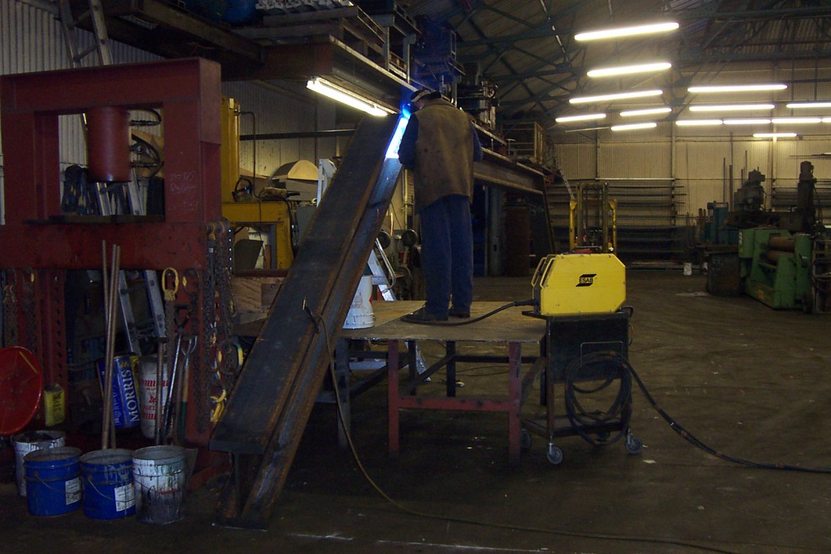

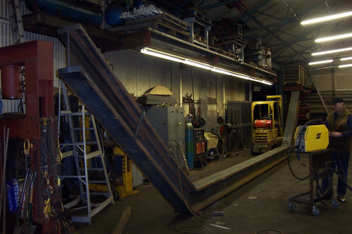

my old shop had a row of double 8ft fluorescents on every truss and could select which rows were on .... with a few extras where necessary .... gave a decent level of light to work in .... building was 150 x 60 ft .... long before LEDs

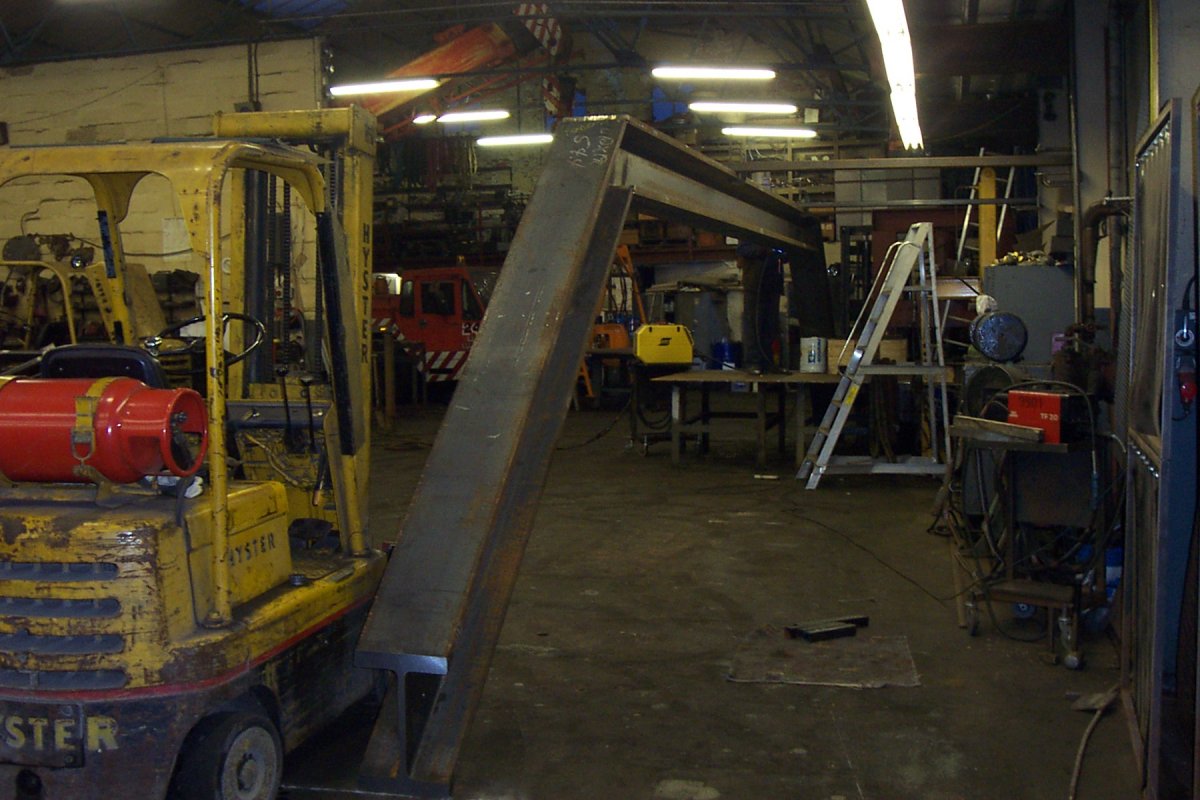

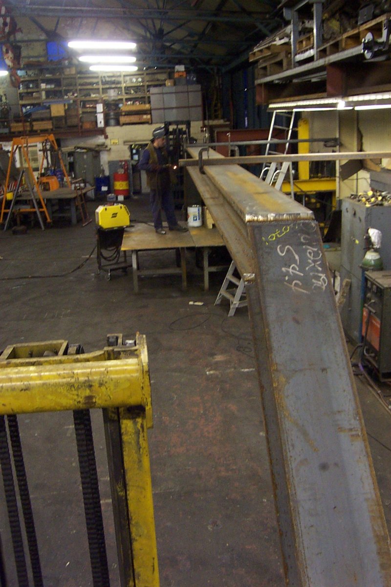

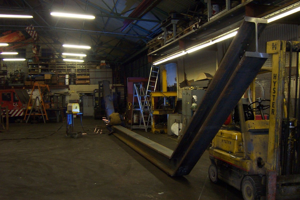

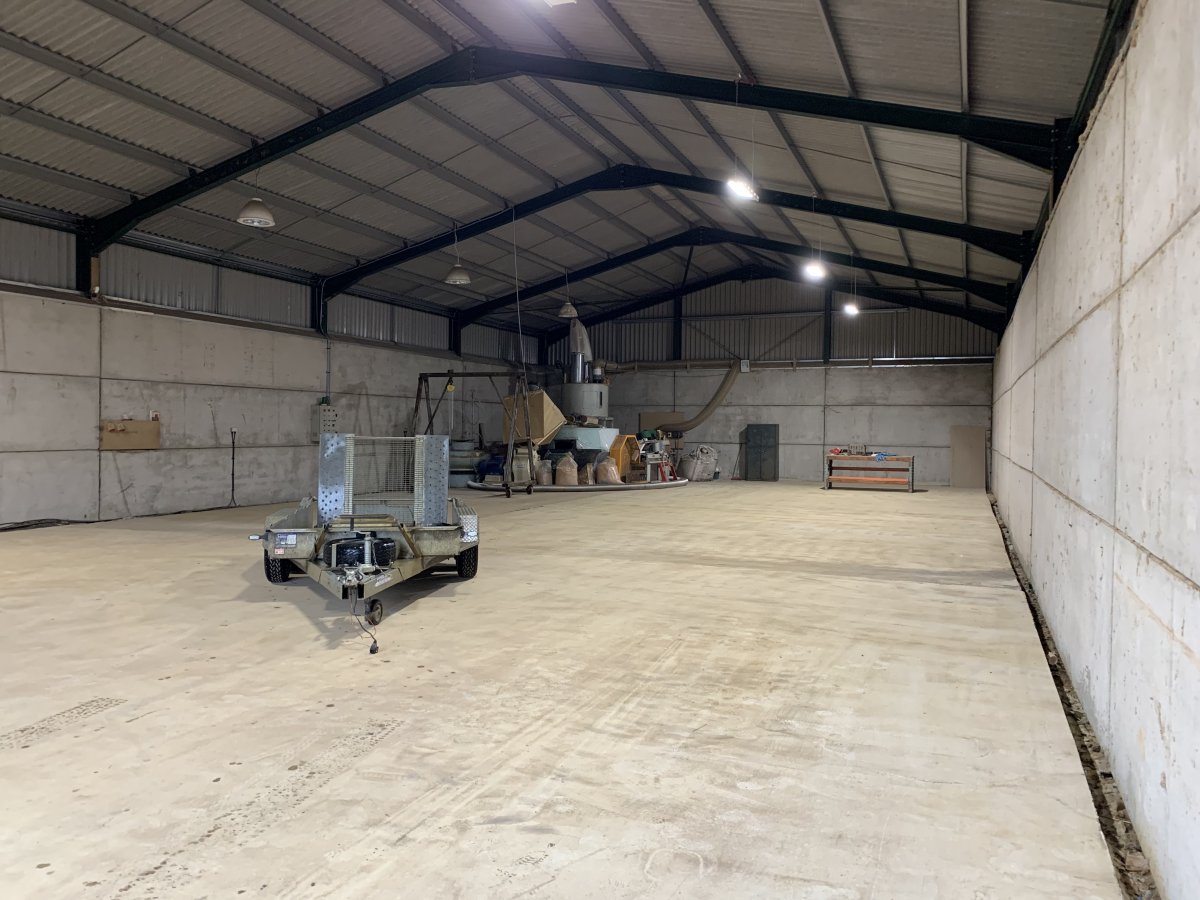

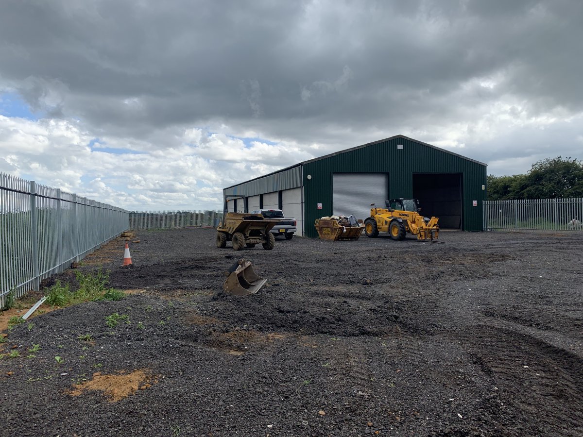

I need to light this up without harsh on your eyes
At the far end where it’s darkest is the workshop corner where we get harsh shadows the lighting that isn’t on is really lame. We need to start again with it all as the leds thst are up are harsh and don’t give of a nice light . The only natural light is the rollers

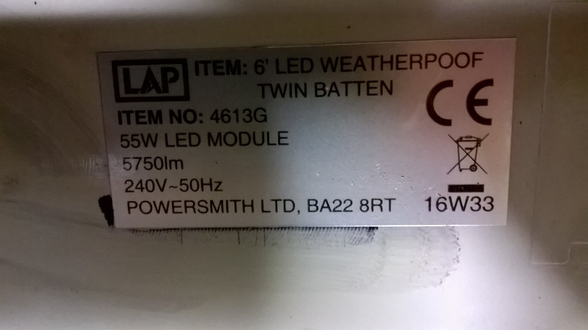

those LAP LED 'fluorescent' units I bought and stuck up in me black shed give amazing light ... with the diffusers on they're excellent ... without, they're too bright to look straight at !! ... they're strips of LEDs fitted in the batten cases .... wish I could find some more of 'em

I have 6 LED low bay panels in my 18m x 14m shed, they cast no shadows, can see right into the corners no problem. So bright you can’t look up when they are all switched on... can’t remember the make and I don’t fancy getting up into the roof to have a look!

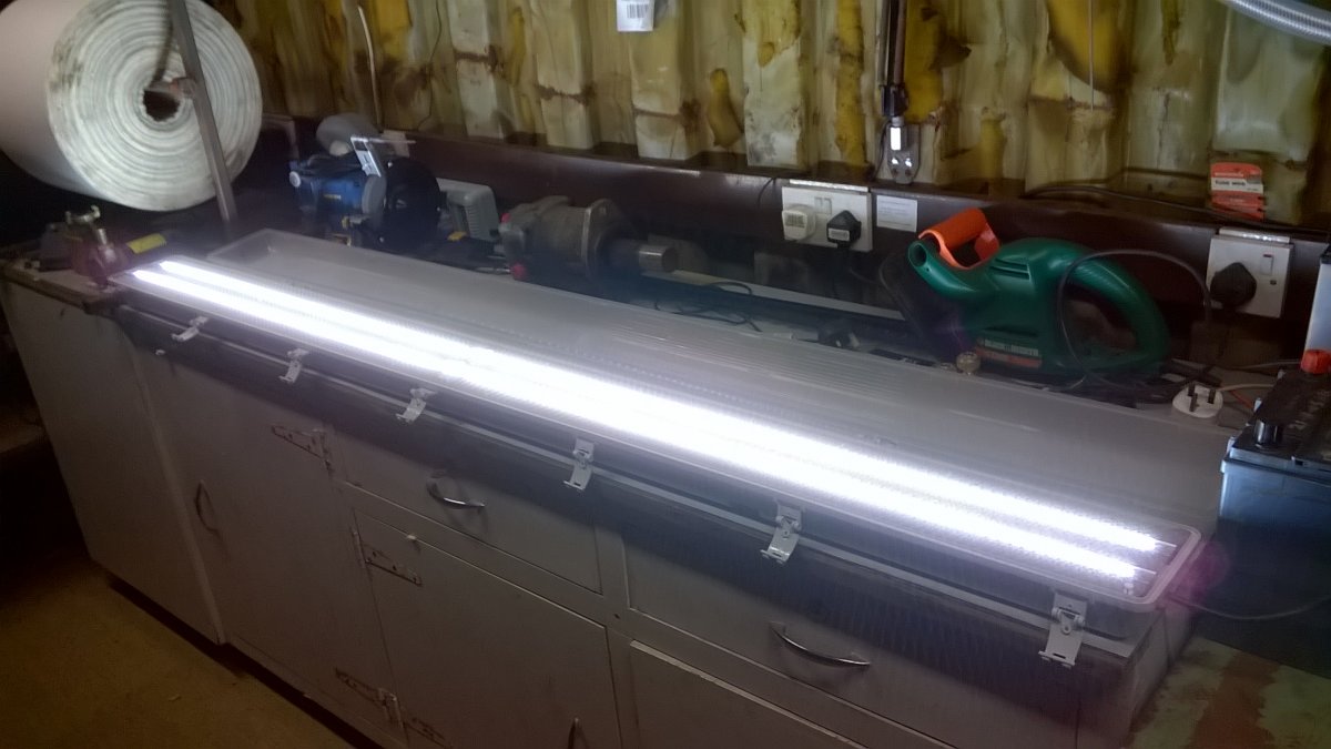

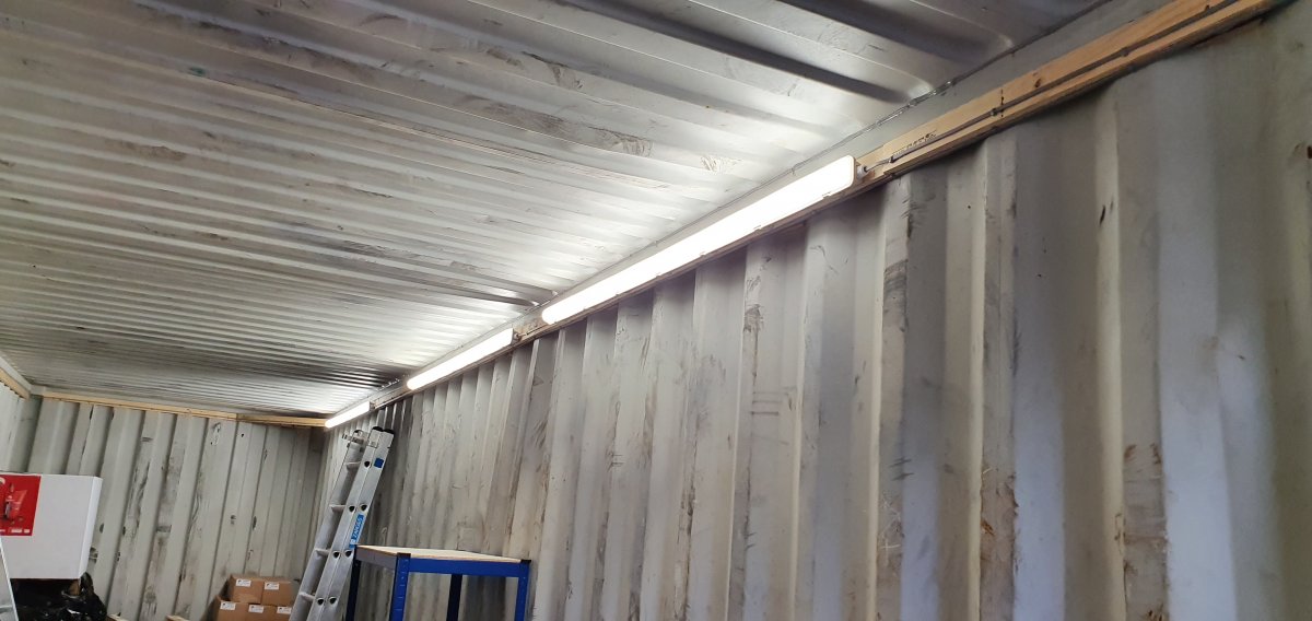

I love LED Strips like Druid.
Just fitted a few:

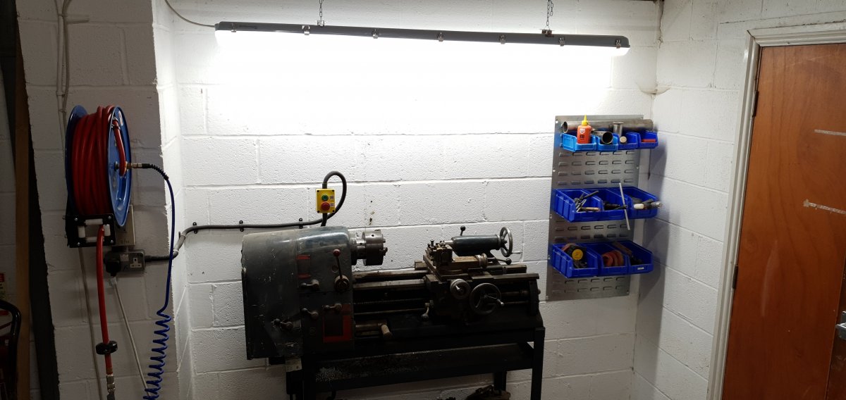

1 over a little lathe:
And a few in 40ft highcube box:
Brilliant light if you can get them down low enough?
