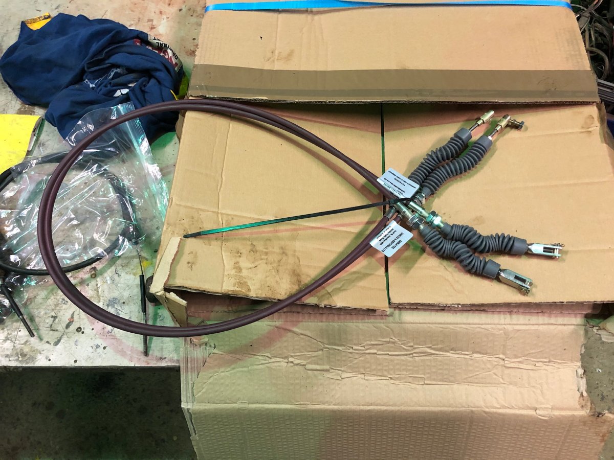

Just to update on my previous post.
I sent off my old cable last week, Wednesday iirc, received a quote on Thursday and have had the new cables arrive today.
Cant really fault that service imo, and they look good to me. I have no reason to think that the new cables are not of good quality and will not give years of service.
Im impressed with Cable Tec and highly recommend them to anyone who needs a control cable made to spec. And tbh I thought they were very good value too.
