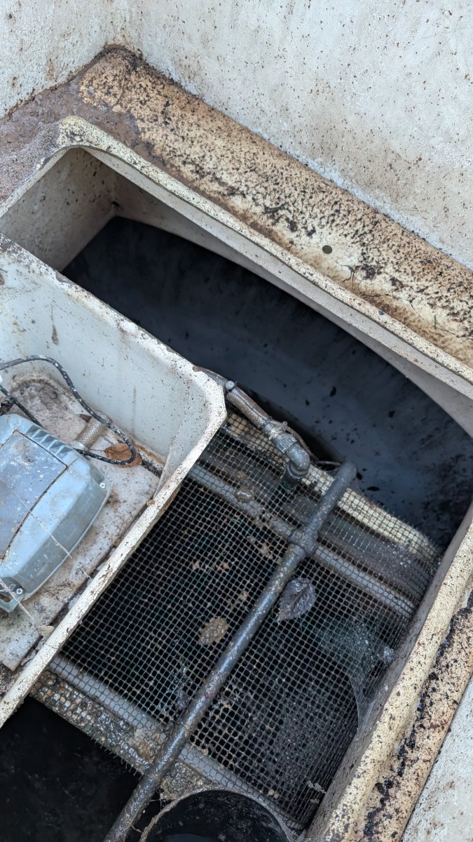

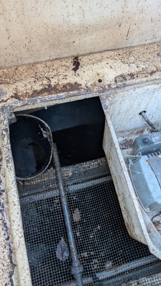

Ok...just had marsh emptied.
2 years old , had a lot of crust and sediment so going to do it yearly going forward. I reckon it's her insinkerator filling it with crap...and yes we've had the discussion 😬
Apart from that all good. Blower still chugging away
Lad did say they've packed in installing tanks and just sticking to emptying etc now as most round us are on clay and need pumps as low lying and always cause aggro.
Pics for the tankophiles.

Them old marsh tanks with internal compressors are a pain!!
If the condensation doesn’t kill them a flash flood instantly does!! 🤯
