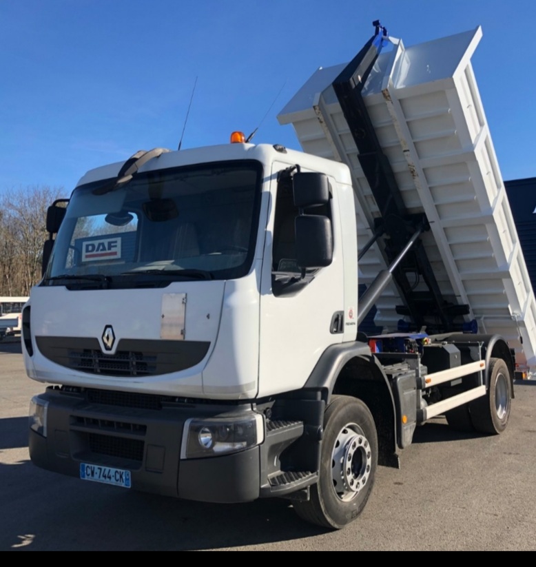

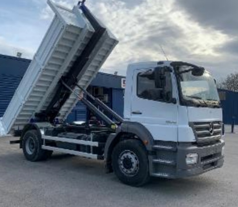

Couple I've seen of interest
Merc axor 1829nl 2012 225,000kms
Renault premium 280 2009 170,000kms
Both same money - reconditioned with new 14t hookloader gear - both carry about 9.5t with a skip on.
Both 4.1m wheelbase
Unfortunately neither seem to have exhaust brake or equivalent..... is that a must ?
Merc versus Renault ?
