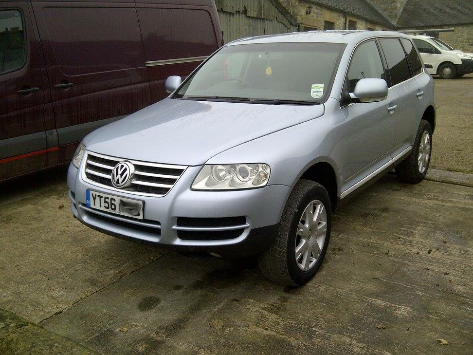

Had one of the early pre faclift touaregs, 2.5 tdi 174 engine same as fitted in t5 at the time. Was a nice enough tool, and a lot of car for the money. I think the newer ones you have to spec them with towbar prep from new as they can’t always be retrofitted iirc
It would be an older one i would go for, and would have to have a towbar fitted already as i wouldn't want the hassle of it. Was your 2.5 tdi 3.5 ton? some of them are less?
Yes mine was 2.5tdi, 3.5t towing capacity. Thought they were all 3.5t towing to be honest but looks like the r50 and petrol models are less. Got me about in most conditions, had a centre locking diff too iirc.

My Dad runs a V6 TDI and has done for quite a few years pulls 3.5ton no worries at all real comfy had some all terrains on for a while managed well in the field,
Nice Vehicle tbh

Aiden,
Toureg is a good yoke. Its a few years since I sniffed around a few looking for a mule, but if I recall correctly it's only the 3.0l V6 that can pull 3.5 tonnes.
They'e a bit harder to find than the 2.5.
All models are pretty bulletproof except for the centre bearing carrier on the propshaft which is known to fail.
Go to VW and its supposed to be a replacement propshaft unit @ £900 and then the labour. They say the mount cannot be replaced in isolation.
There are now aftermarket kits allowing you to cut off the old bearing and fit a replacement split mount for a couple hundred squids, or you can buy replacement aftermarket propshafts for little more.
It's a good haggling point if you can find an otherwise good Toureg with a grumbling bearing and bargain them down saying its a £1,000 repair :D
