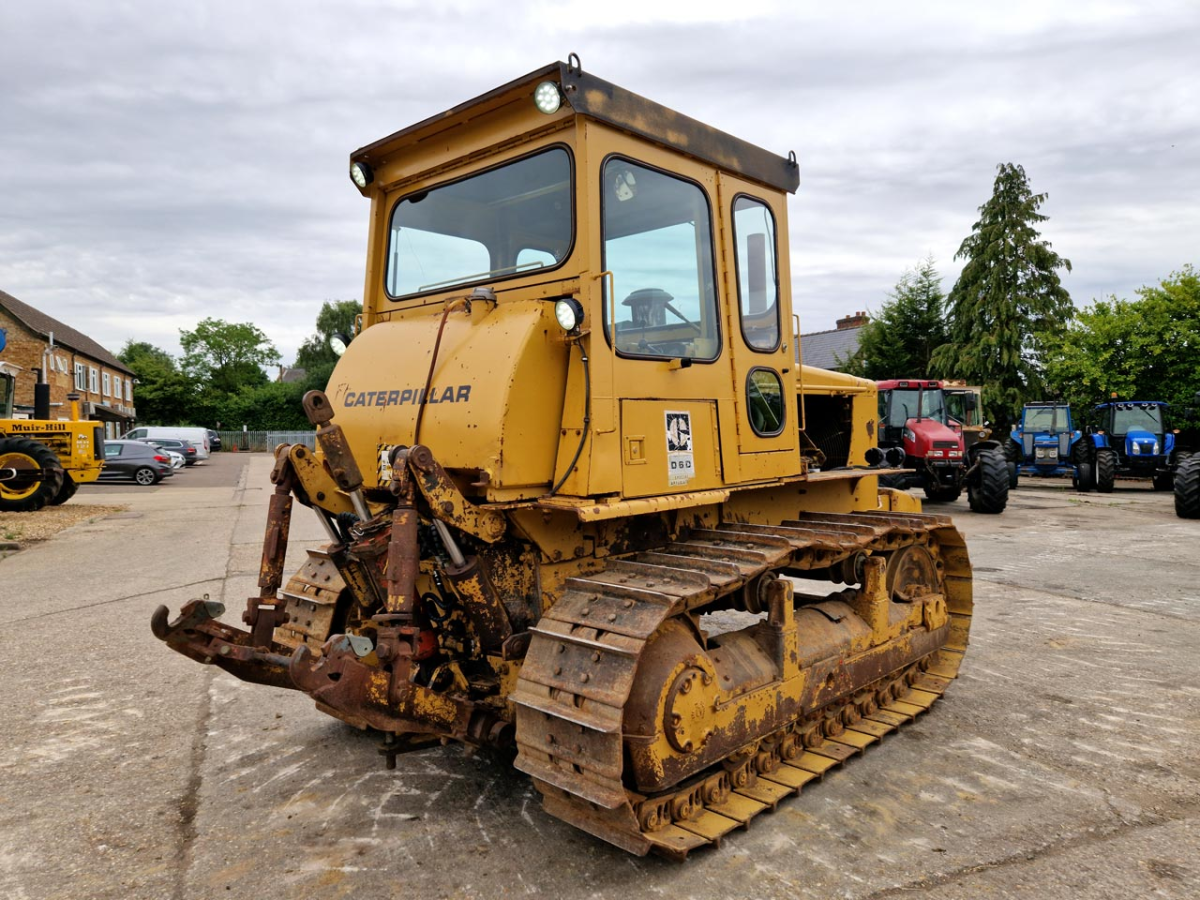

We rented a D6 VHP to till the soil. How does it work? Thanks.

When you put it in 4th or 5th the gear linkage opens up the rack on the fuel pump.
What type of transmission does it have? Hydrostatic, hydrodynamic, hydraulic, power shift converter?
How does it work? I'm a total noob in mechanics. Could you explain the concept to me with some simple examples? Thanks.

The Caterpillar D6D SA VHP (Special Application, Variable Horsepower) is a highly regarded agricultural crawler from the 1970s/80s, featuring 165 HP in lower gears (1-2) and 216 HP in higher gears (3-6). Designed for heavy, efficient field cultivation, these tractors often lack dozers, focusing on high-drawbar work.

They have a normal gearbox with sliding mesh gears and an oil bath mechanical clutch. The gear linkage connects to a mechanical fuel injection pump and in the higher gears increases fuel supplied to the engine.
so on the diesel injection pump, the more revs the more torque I assume if I understood correctly thanks
