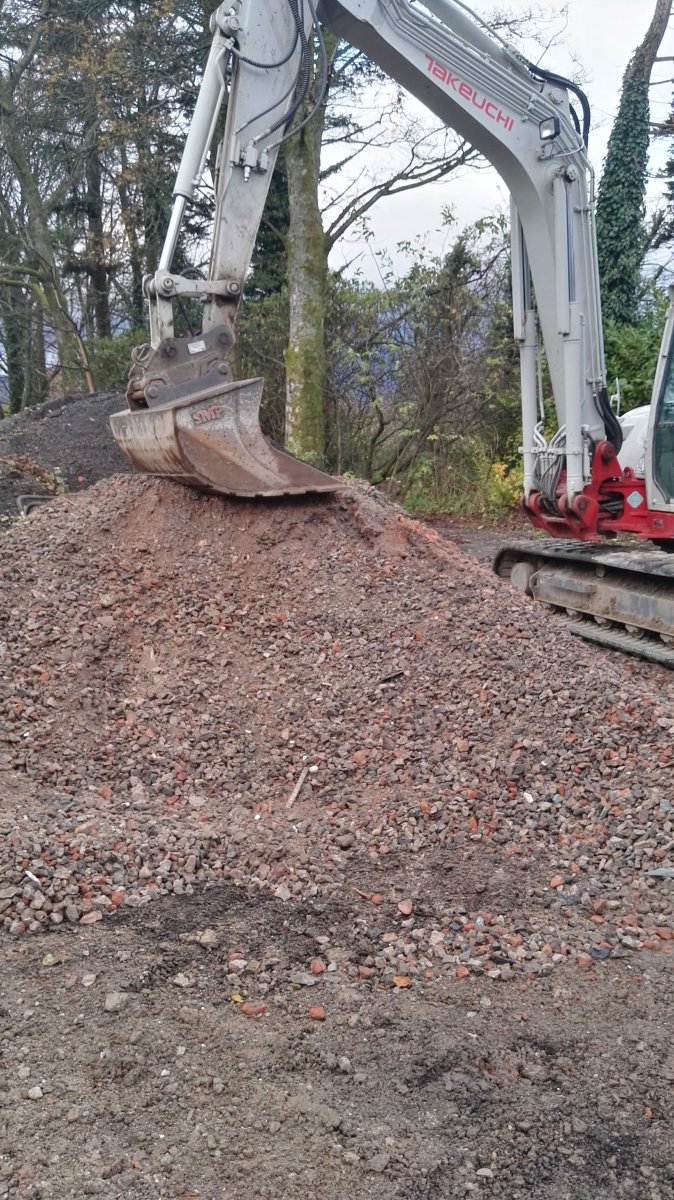

Depends where it comes from, alot of the crushed "concrete" round my way is shit with a high soil content plus all the usual plastic, wood, metal, pieces of asbestos and what ever other crap bellends have tipped in the crushing pile. Also tends to have pieces to large for a Wacker so ideally needs a roller, then when it gets wet looks like mud.
Can also get a recycled type one round my way that comes out of a wash plant which tends to be 10-40mm mixed with "sharp sand" off another belt, all depends how it's mixed together but one issue is the moisture content from being washed so can bring water to the surface when Wacker although to be fair goes off solid when dries out.

Biggest thing with crushed hardcore other than amount of sh##e in it as already mentioned is size. Most people running crushers don't like running them below about 80mm so not only do you get a heap of big lumps you don't get much fine stuff so it doesn't bind when you compact it so it's only any good for bulk fill. If you can get it crushed 40mm down you can get some really useful hardcore tho i would still top with type 1 if driving on it.
