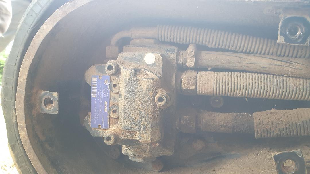

Kx71-3 tracking motor turns a bit in each direction .... like a couple of cms in either way then stops with a bang 😡
Did appear to stick a few times yesterday.
Nothing jammed in track so something gone amiss inside by the look of it !?

Something loose in the planetary gears or motor come apart inside itself 🤔
Drain your gear oil and check for metal, sounds like a broken gear, if caught in time it should be fixable at a low cost
Most likely a tooth off a gear. Like said, take the cover off and have a look. Might be a cheap fix if you catch it now.

Cheers for the replys (y)
Cover plate looks a bugger to get off and I know fiddlesticks about them so might as well just send it to the right people...... any suggestions for a quick turnaround ?
Yep I understand the plate part, had a bit of a google and I see they can be difficult to get off, not that thats not doable but dont want to spend a lot of time getting the plate off and ordering bits and messing about with it, think the best will just be to send it to someone who knows what they are doing.

Almost definitely tooth come off.
As always with final drives my advice is just to ring FDC and get a replacement unit. I know Tim did his kubota himself but IMHO it's not cost effective.
It can be, if its no to far gone, in this case its been caught in time and not dogged around a site until someone asks whats wrong with that machine!
For instance, a new drive could be £1500, this could be fixed for 150 if not much wrong
I have emailed for a few prices - quick search shows its going to IRO 1400 +VAT

Yep will prob just order one up and save loosing too much time messing.

If you're gonna be buying a whole new motor you have nothing to lose having a look in your own. May as well take plate off and have a look at gears you don't have to start buying parts but you might find it doesn't need much to sort it

As for your final drive Furness, as others have said, whip the plate off the front and see what you've got. Until then, all these prices for new bits are stabbing in the dark.
