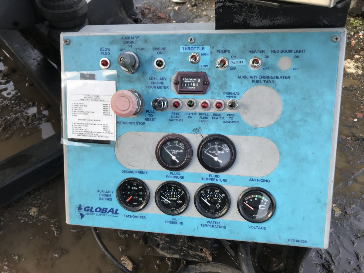

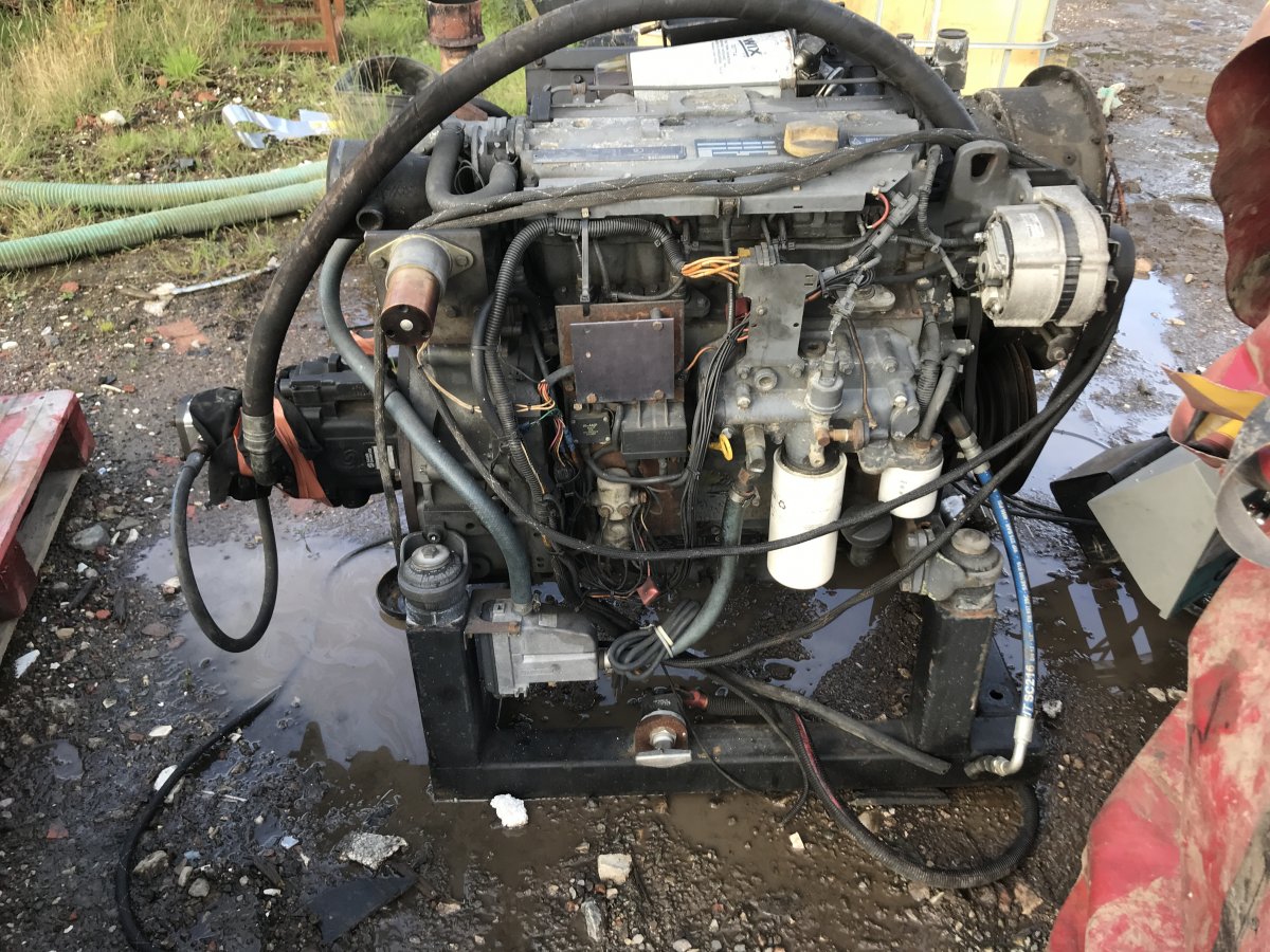

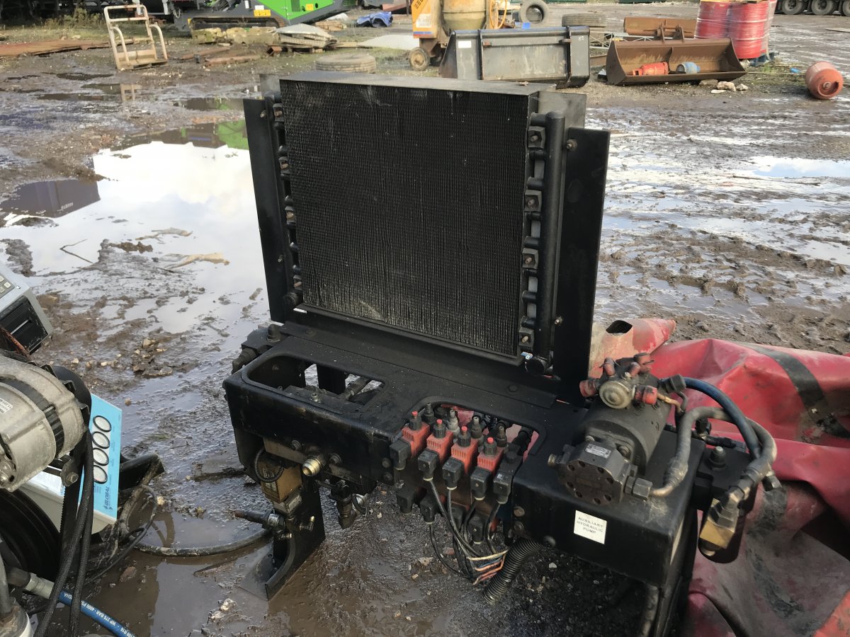

Short of an extra engine and pump with own cooler and oil tank mounted on rear or a trailer towed on dozer blade and long umbilical pipes no is the answer
Now then....mog?
Piece of piss😉 got a deutz turbo with large pump and cooler ready to go
even got a dash board for it😂
