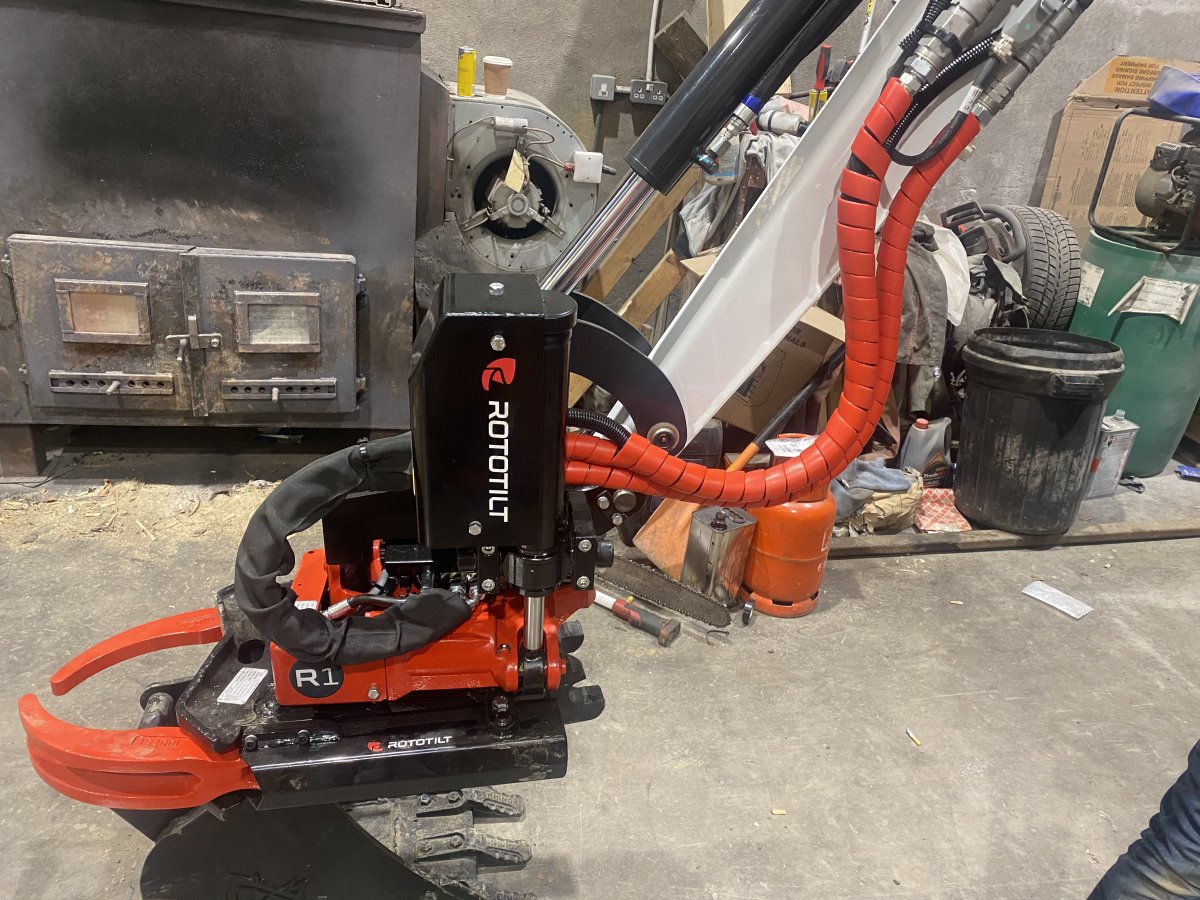

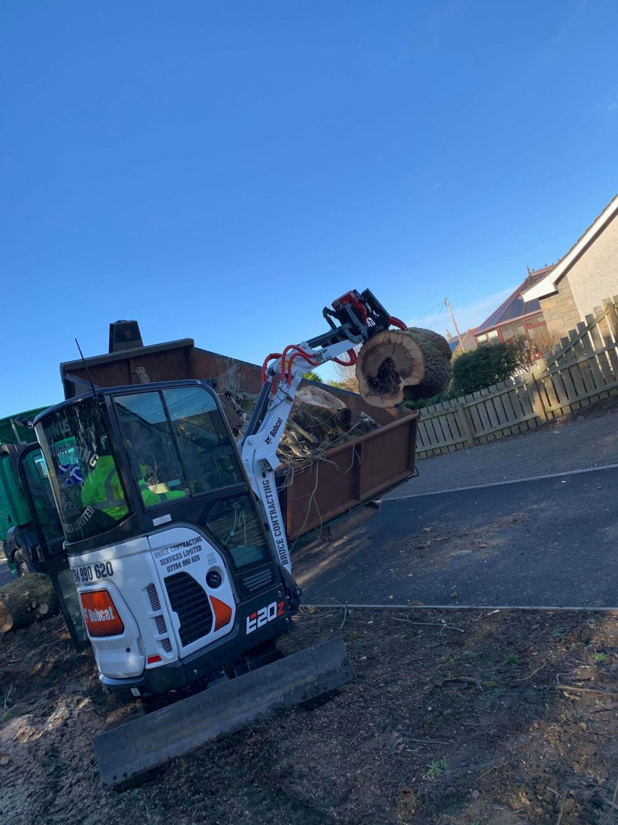

Here is a little bobcat E20Z that I fitted a Rototilt R1 running S40 so the owner could have the gripper module, on paper this set up is far too heavy for the machine but it handles it very well, this has gone for full ICS control system.
For me I think you need to get the full control system
I'd agree (y)................ if he can justify the outlay :rolleyes: ...... if not .... pedal and buttons'll get him twisting and tilting for a minimal outlay, in comparison and perfectly workable alternative on a budget ... for a start
that rototilt looks less half the size of my engcon S40.
