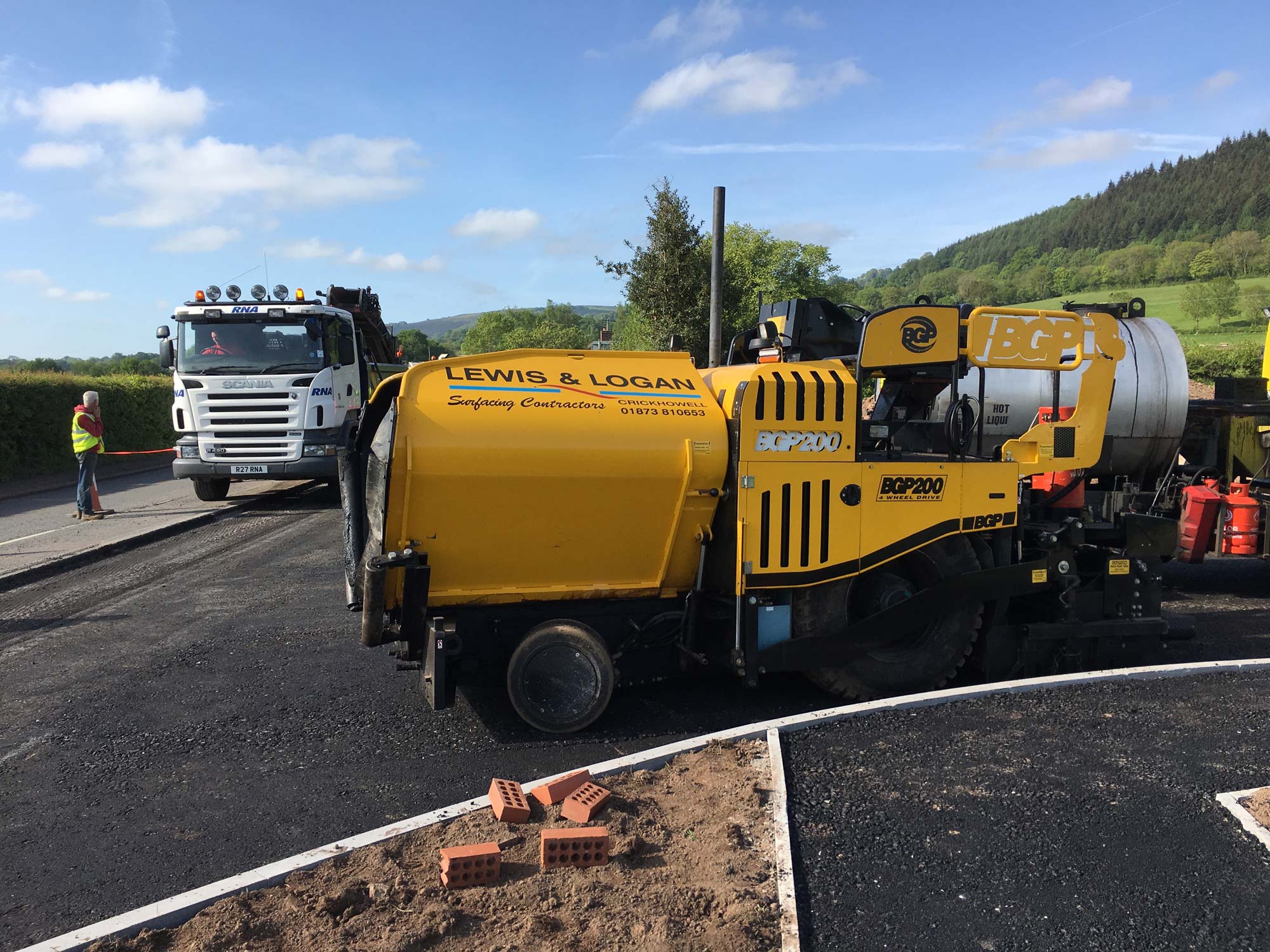

Having to make a good an entrance way on a build with tarmac once I've ripped the services through.
Planning on taking up whats is there and then putting 250mm of type 1 compacted in 75mm layers with a roller. The tarmac guy has quoted for 50mm of AC20 binder and 25mm SMA6 suface.
I know bugger all about tarmac but this will have to take many full load 8 wheelers, artics with bricks etc going over it. Will what's been quoted be sufficient not to rut ?
What should I be paying a m2 for it bearing in mind I'll have it kerbed and stoned ready ?
thanks
