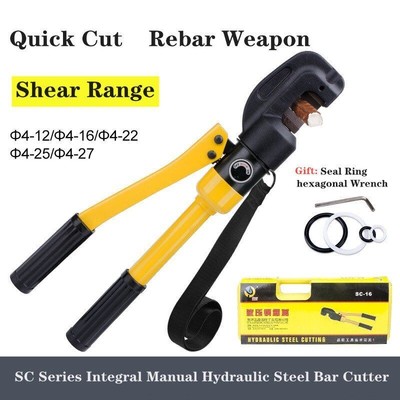

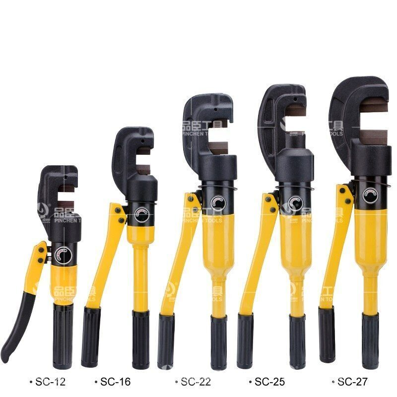

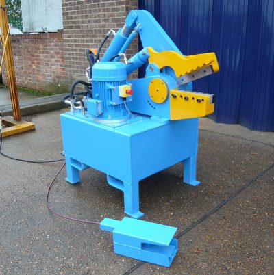

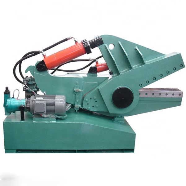

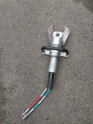

can of freeze and a sharp cold chisel or one of these
couldn't find what I was looking for :(
can get much smaller versions -
I have one smaller still
... but these'd do the job
can't find a UK made one -- IIRC Ficep used to do one

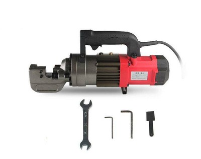

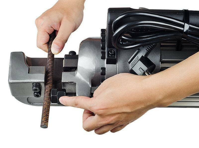

Milwaukee do an electric shear for threaded rod so should work on rebar to providing it fits

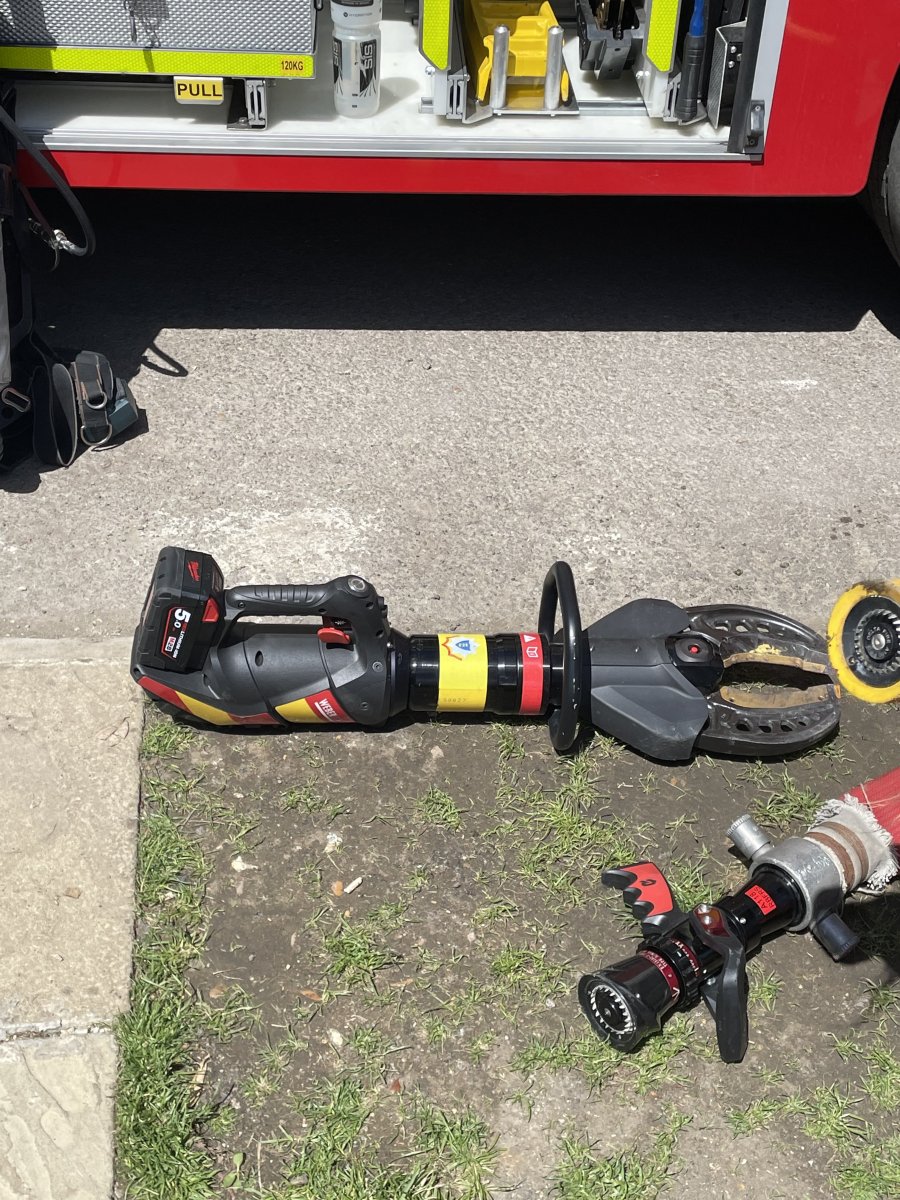

Battery powered jaws of life would cut a bit of rebar.
When these things get into the wrong hands there won’t be a shipping container safe in the country
