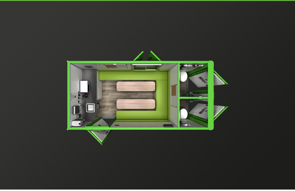

Had a good look around the welfare units at plantworx earlier this year.
must say was impressed with this lots offers. Cant imagine they r at cheap end of scale tho..
https://ecohireltd.co.uk/ranges/product/eco-16/
like the gap between the narrower tables ... saves everyone getting up to let the bloke in the middle out for a waz :giggle:
Two toilets !! So two labourers can hide at once.
Tbh I prefer having a drying room and if necessary a second independent portaloo. No way does a second toilet beat a drying room.
