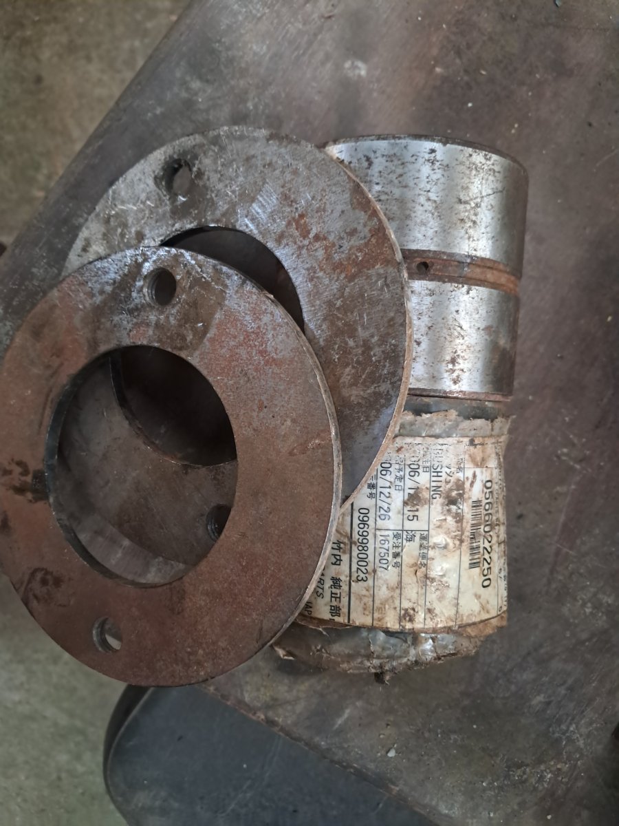

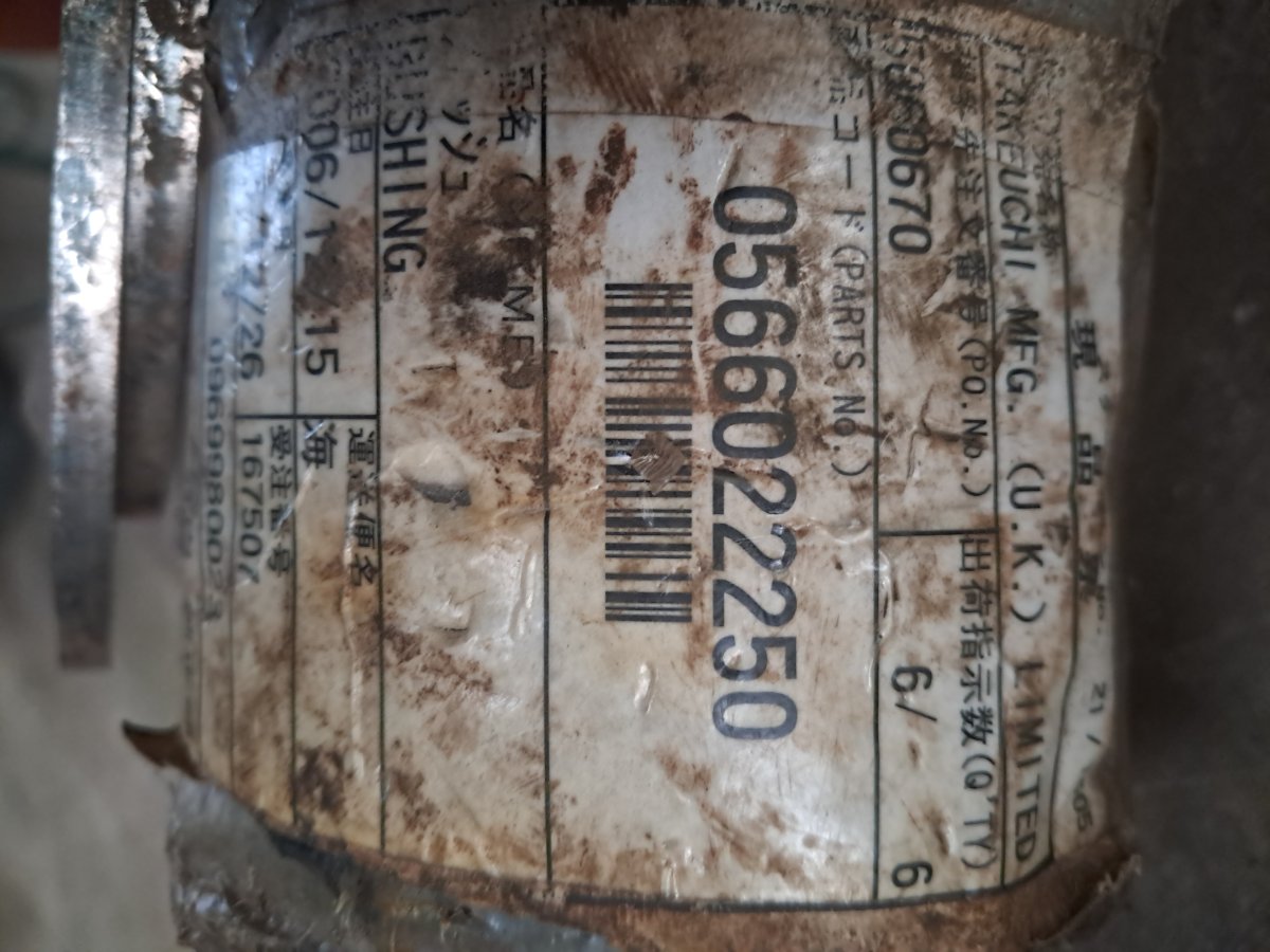

I may still have some bits under the bench from this...
As for quality, as long as there hardened pins and bushes you should be fine and last every bit as long.
Some companies supply ET24 pins and call them hard. Well there not and the hardened bushes waer them out super quick..
