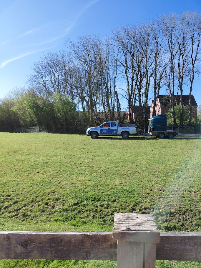

I know a few folks with them and they all say they are better than either of the previous engines. Not sure about the 1.9l but the 2.5 need keeping on eye on the engine oil as they like to regen and can blow derv into the oil which doesn't have a drain so fucks s**t up if left unresolved. Dads 2016 Dmax is pushing the oil level up regularly now at 120K ish. Mine is okay so far. Other than that I cant fault the poverty spec utility as a tool. If I was spending more time in one I would want Autobox and airbags on the back. Factory radios are s**t. Rear tailgates only seem to cope with about 400kg max when using ramps. Full dumpy bags of frozen 803 will break them.
My old ranger (older than yours I think) 57 plate Thunder was a much nicer 'car' to drive than the Dmax.
