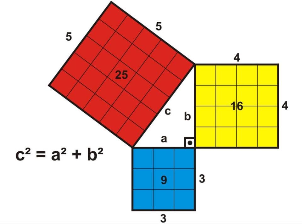

meant to put this one up a while ago, after I tripped over it one night ...
always sounds such a mouthful, trying to explain it to ppl ...
Pythagoras' theorem is a fundamental relation in Euclidean geometry between the three sides of a right triangle.
It states that the area of the square whose side is the hypotenuse (the side opposite the right angle) is equal to the sum of the areas of the squares on the other two sides - (the opposite and adjacent sides).
or
this is it in a simple diagram
or
View attachment 46692:cool::cool:(y)

3,4,5 is handy and quick but I'll either use the easy square or just use the calculation
√((Length X length)+(width X width))

3,4,5 rule is so simple to use for squaring out but SOH CAH TOA is occasionally needed
