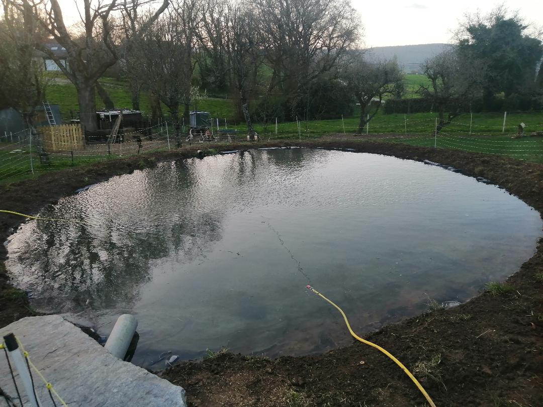

I went back to put a liner in one last week of a similar size for a customers ducks and assorted buggerment :) we did a septic tank and drainage for him last year, he asked if we could create a small pond on the sloping garden with excess spoil from the job ,done a few over the years but im no expert and might learn something from this thread 👌 customer bought the liner and got a decent rubber type not plastic (dont know correct term) then I dug trench about 30cms deep and level around outside with top edge of trench just above outlet invert and tuck terram and liner into it before backfill and creating edge of pond.
Seemed to work fine - hes going to rake grass seed and mess with the edges
Sent me this photo and gave us these
Nitrile ??:unsure:
Nitrile ??:unsure:
Butyl maybe?
Either way unless you're in an area where you can dig a hole and generate you own clay for a small ornamental pond with no permanent feed liner is the way to go. Rubber liners are a lot better than plastic they follow the shape much easier and with less creases and folds.
