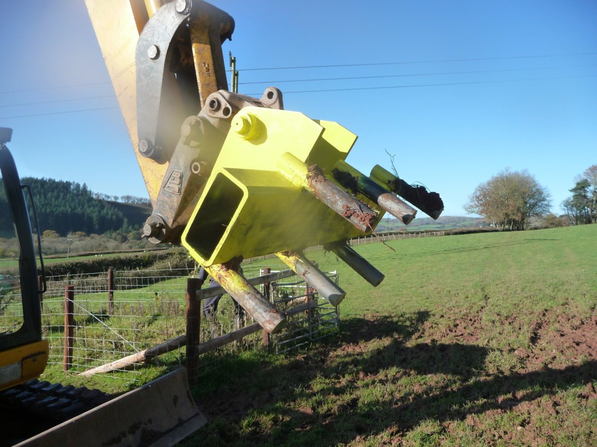

Might have 10k whips to plant at short notice. Anyone got any experience mechanising the process? Or is a tree planting spade the best method. There must be something I can attach to my 2.7 tonner.... suggestions welcome 🙏 Tree planter Nov 2020 (10).JPG
I saw this..... looked like a good shout.... but I'd probably do wedges rather than tubes
Might have 10k whips to plant at short notice. Anyone got any experience mechanising the process? Or is a tree planting spade the best method. There must be something I can attach to my 2.7 tonner.... suggestions welcome 🙏View attachment 79582
The tree planting blokes are unbelievably quick, nothing on a 2.7t machine will compete. The only way you will do it quicker is with a tractor trailed jobby.

I think it'd be quicker on my own with a spade 😂
Yeah... it's something I've done a fair bit of but not quite at this scale. Maybe I'll look into the possibility of using a tractor and see if there's an attachment I can hire
I saw something similar yesterday online . Guy was planting a twin row hedge with a 2.7t and had spikes welded to the bottom of a frame with the rows staggered . It looked about 8ft wide . I thought it was a great idea and wished I’d of thought of it when I planted my hedge .
Yeah I saw that one as well. Bigger than 2.7t I thought ?
10k is a days work for a planting gang with spades tbh.

Its canes and guards too...
looks like hard back breaking tech
Yeah, doesn't look like much fun. Three blokes with spades would be comparable in efficiency i would say looking at the video, and looks like a double row would be out of the question
