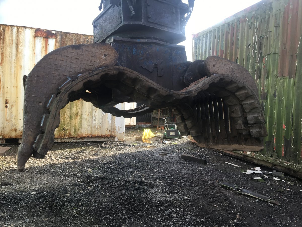

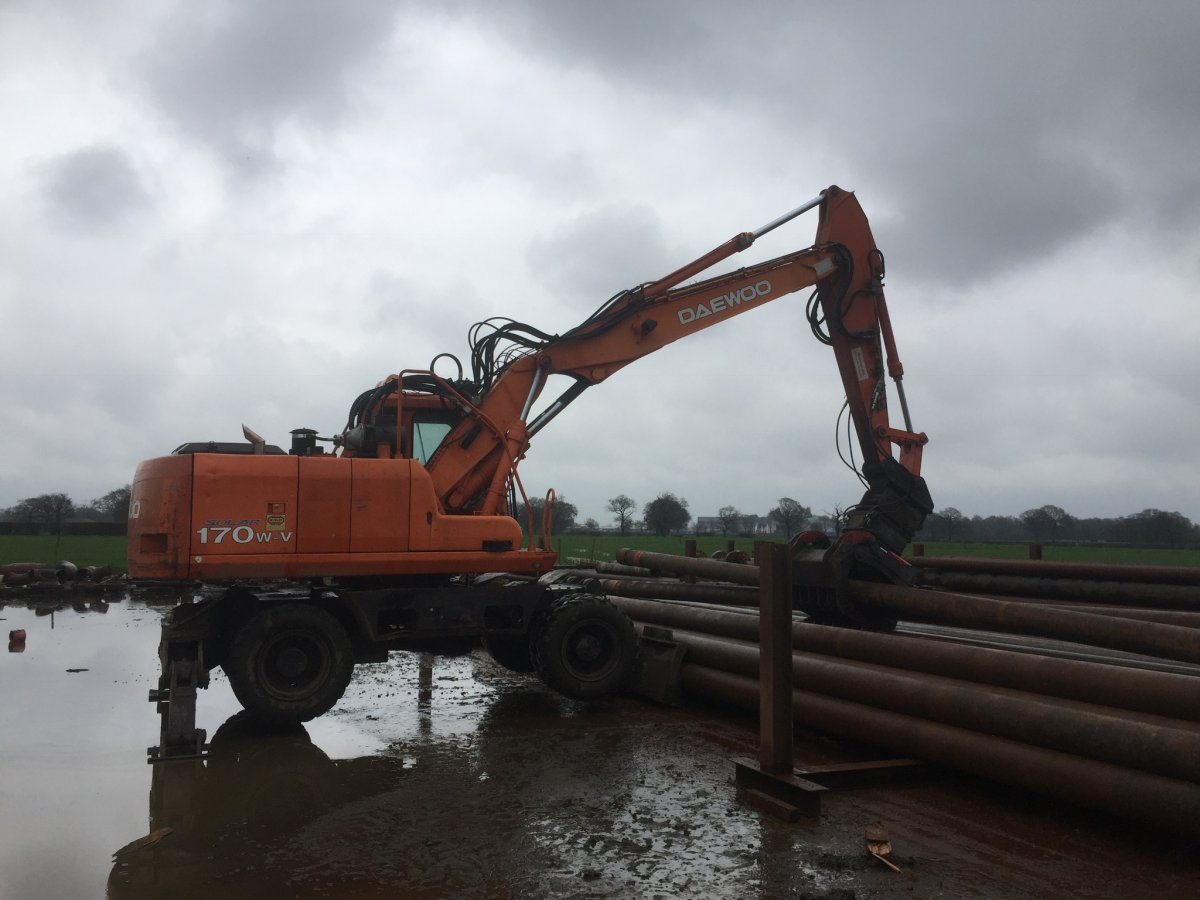

Got a job starting next week loading drill casing tubes about 300 tonnes:D onto 40’ flat trailers, now last time I used this
But alas some scrote stole it for a site of mine so needed a plan B:unsure:, now I have a selector grab but unless I can get 5 pipes in, it won’t grab them and because they weigh a good half ton each I can’t lift them very well at a reach:oops: three is a nice weight but they can slide out and as the grab is only 3’ wide and the pipes anywhere up to 45’ long they take a bit of balancing plus a steel pipe in a steel grab:eek: can be a bit hairy at times, so had a few thoughts bouncing around my head over the weekend of fixing some form of rubber to the grab:unsure: bit of conveyor belt? how do I fix it to the grab, old truck tyre that has had the tread delaminated (see loads at the side of the road) but how to hold them on:unsure:

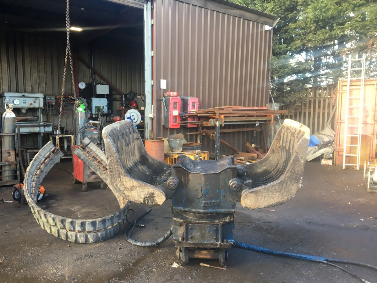

Then eureka:D:D an old rubber track(y) had a root around and found one
So cut it in half and welded the steel cleats to the grab

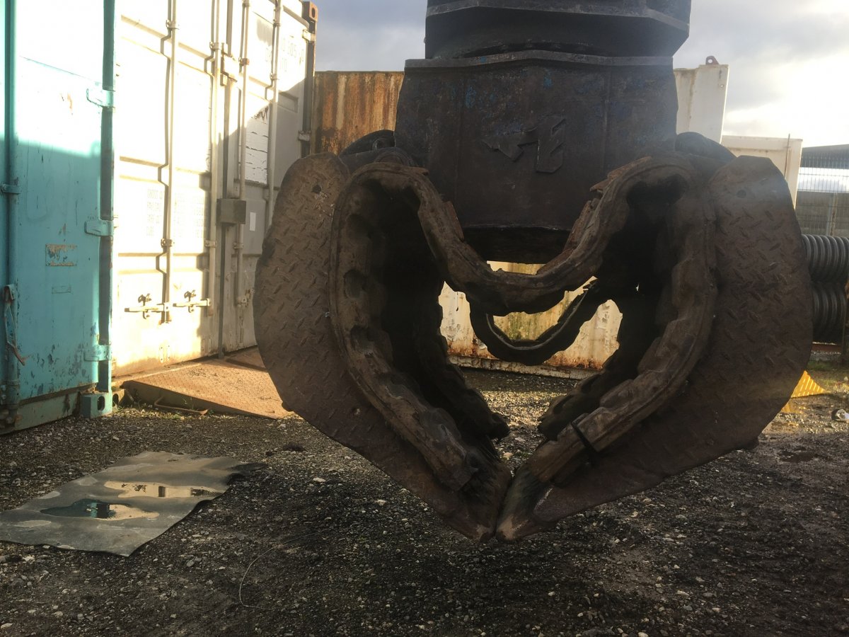

And when it’s closed a loop from the top comes down so should help hold the pipes
So as long as the track holds up to being flexed the ‘wrong’ way should workout (y)
