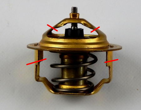

Thanks. I took the thermostat out and ran it without. I’m waiting for a replacement.
Gecko
Gecko
Depending how the circulation flows, you can end up with poor circulation and hot spots running without a thermostat.
It's safer to cut the center out of your old thermostat and run it as "a restrictor plate".
Mick-the-fitter
Mick-the-fitter
It’s what I do!
Without a thermostat it will boil at some point, and that’s why it gets to 100deg
