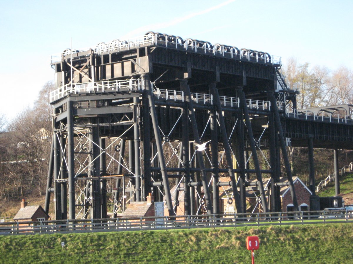

Anderton lift ...... looks like summat one of Mog's ancestors might have had a hand in :giggle::giggle: (y)

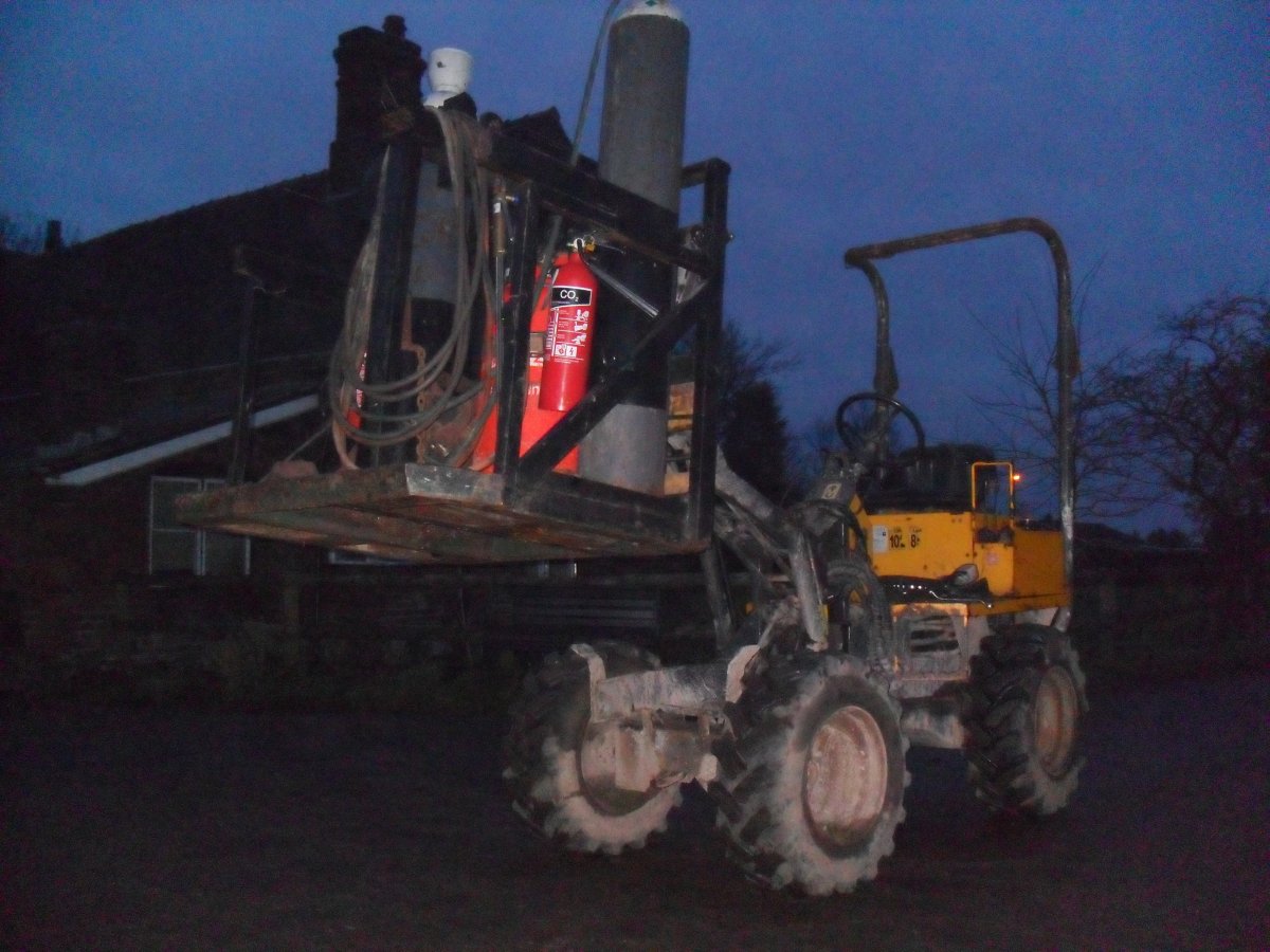

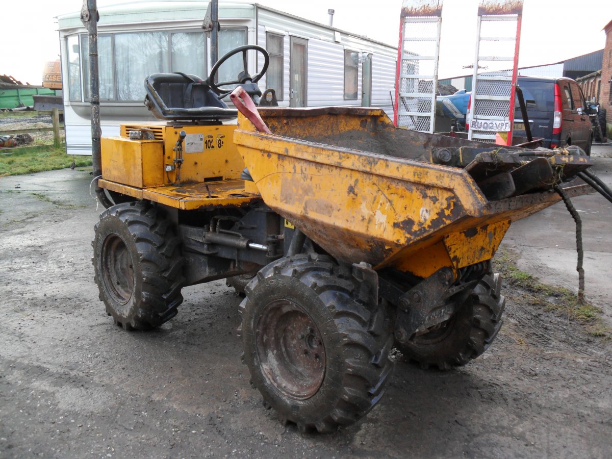

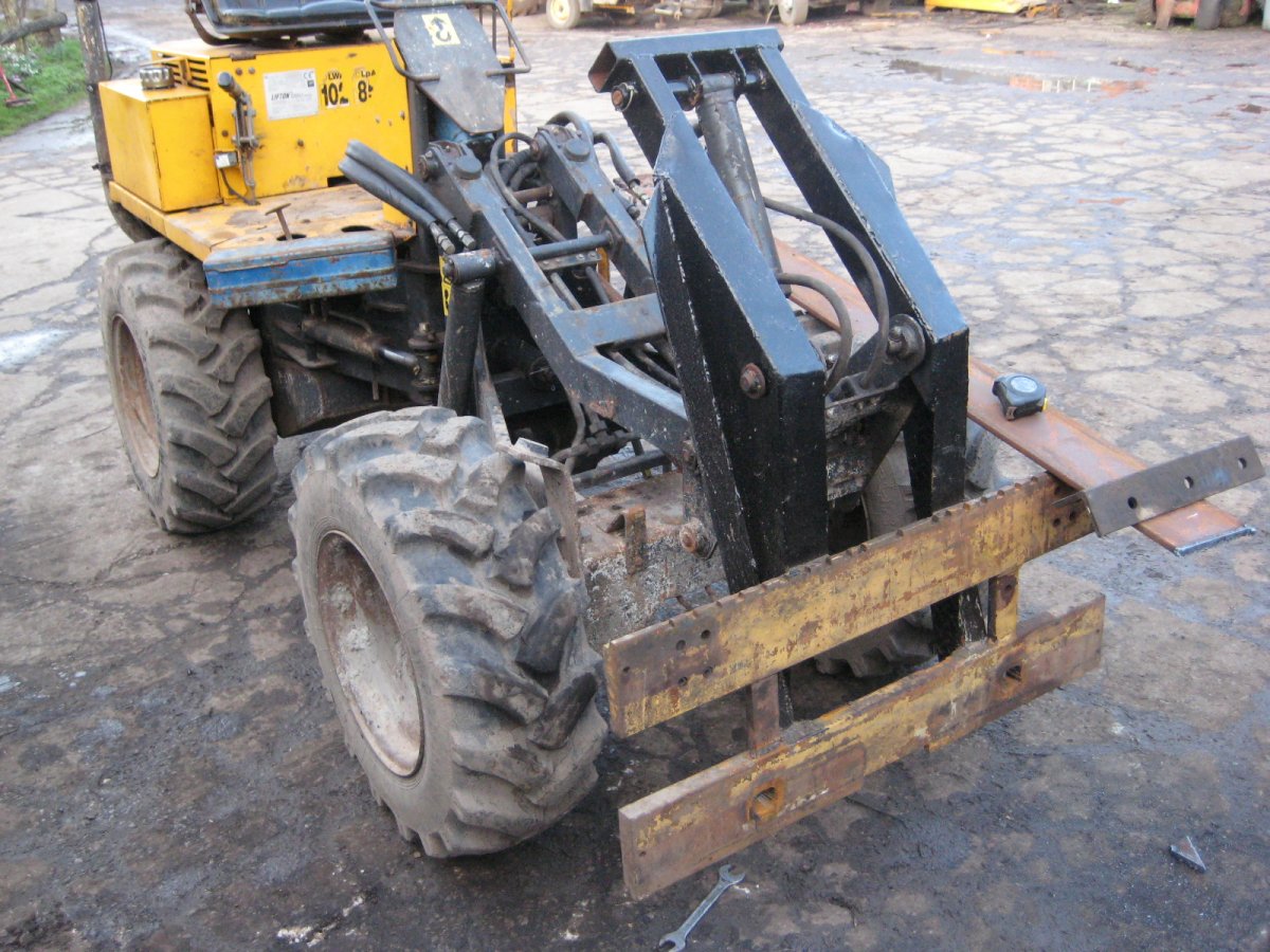

Any more photos of the one ton dumper forklift ?

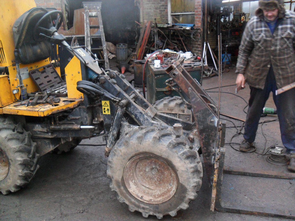

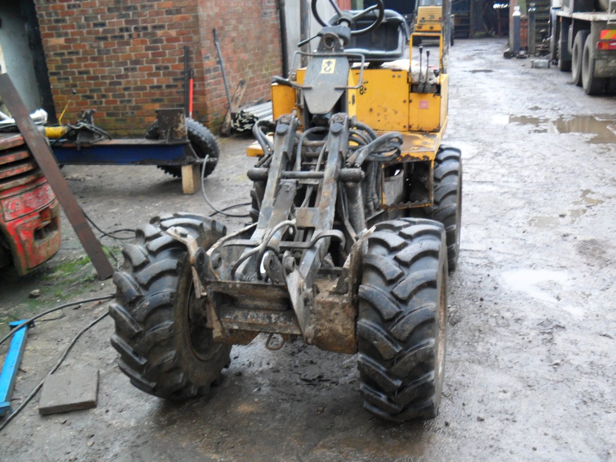

Yes

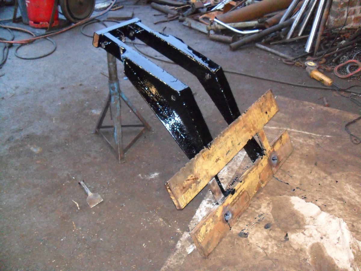

I converted it a few years back now it’s a simple three pin job to swap between the skip and FLT carriage, works very well the dumper was bought with a bit of play in the pivot which soon got sorted,
mainly used as a dumper now as it was converted so it could work inside a building we was decommissioning

Yes

Yes

Thank you that’s very handy might turn mine into one for around the yard ! How much could it lift ?
Not a lot without the back end lifting probably 300-400Kgs but bloody handy
I bet hoping to do something similar might add more weight to the back and have it in the yard with a bucket on !
If you do take a few pictures of your creation (y)
