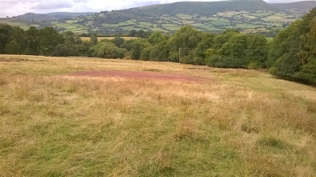

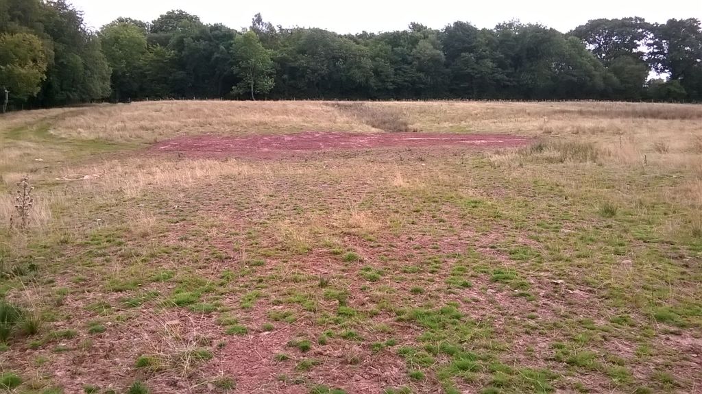

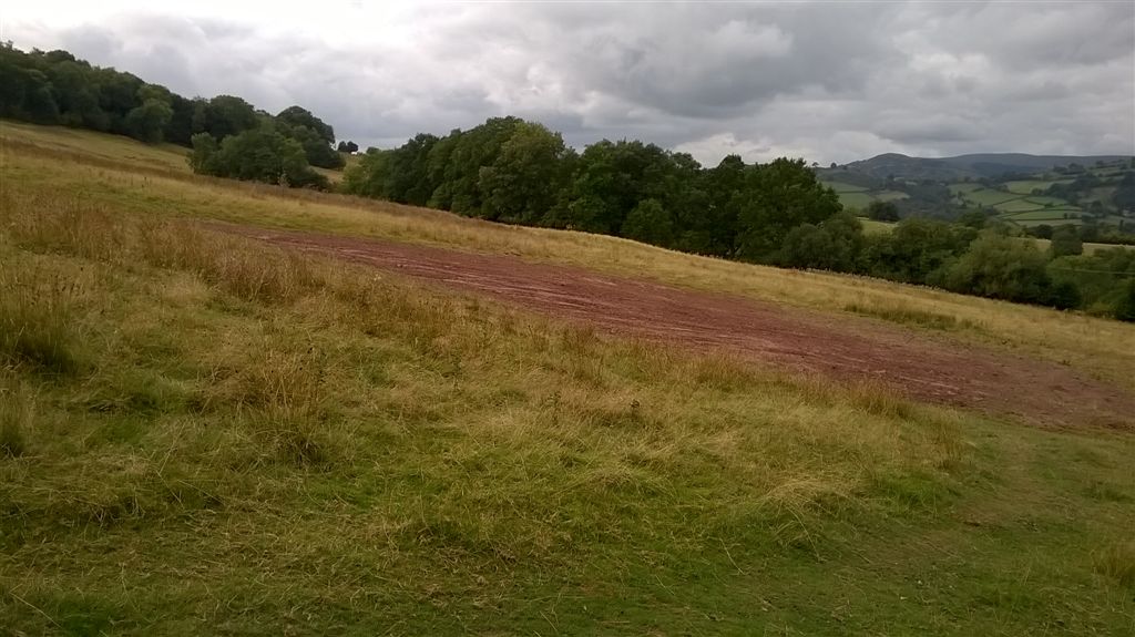

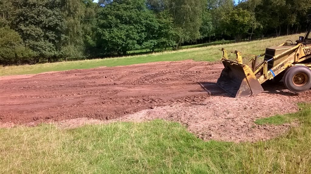

So out of interest how do you go about legally ‘levelling up abit of a field’? These days? With clean inert as dug material?
tip it in there and level it wiv yer JakieB ;) :giggle:
WP_20180915_12_55_39_Pro.jpg WP_20180915_12_49_09_Pro.jpg WP_20180915_12_53_00_Pro.jpg
'Twas a hell of a hole :oops::giggle:
Feral as Fk
Would have to get Planning, then most likely a Claire and have all the fill brought in from one source and tested :(
Check ..... and I can categorically confirm it was all the finest Werngounsel spoil ... all undisturbed for millenia :giggle: :giggle: ;)
