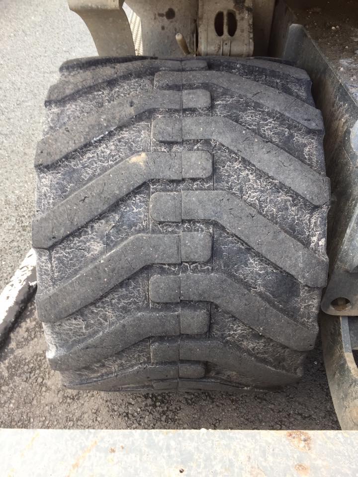

This is them. I believe Rob and lister run them.
vertical learning curve then :oops:;):giggle: ..... axle locks are your friends (y)
Bandenmarkt is the name of those tyres Boyo ;) .... Lister swears by them and has done some big hours with his :cool: ..... the perceived wisdom with off roading them, is the issue of fine shite getting between them and wearing the side walls :(
2.7m is a serious wheelbase/track .... what is it and why 2.7m??? and a VA boom is a must have IMHDO on a duck, for anything other than general use. Dramatically shrinks the size of the machine ;)

I've never tried that type of twin. I can understand where they are coming from with the four side walls, but I would be concerned about stuff getting between them. I guess it depends on the percentage of offroad you expect to do and how worried you are about a bit of rocking. I found it a bit concerning at first, especially on side slopes as you are sat very high compared to a track machine, so it felt worse, but when it didn't fall over I got used to it. I ran Alliance flotation 331 600/40/22.5 which I found good. I have seen pictures of people running ADT tyres which have a lot stronger side walls and a squarer profile like the picture you put up, but as a single tyre.

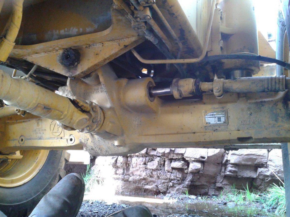

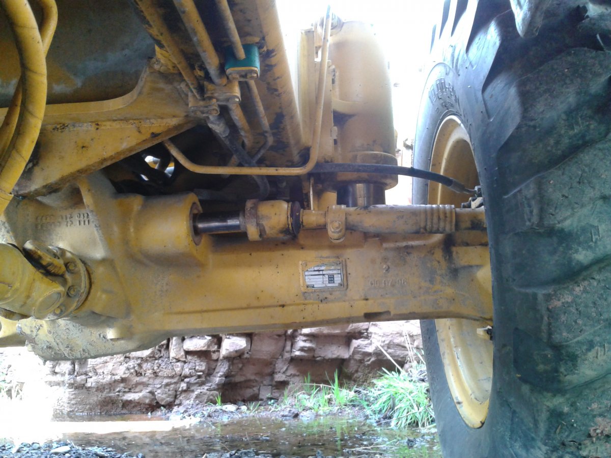

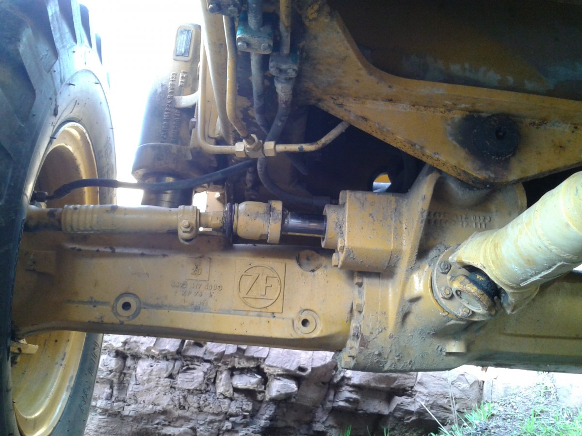

Rob Taylor ... Atlasrob on CEF and @Hydremaduck here ... 'the man' for duck advice(y) ... 's his fault I have one :giggle::giggle: .... axle locks are just that....the steering axle on a duck also articulates vertically about a centre point swivel to keep all 4 wheels in contact with the ground, traveling on anything but flat ground ... but :oops: ... working over the front / steering axle corners tends to lift the opposite corner wheel until the chassis hits the stops (circa) 8 deg.s of movement on the pendle axle :rolleyes: ... comes as a bit of a surprise first time, as it seems like you're going over:oops: .... which you could in the right circumstances .... the axle has a ram each side of the chassis to lock it in whatever position it's at, when the lock is applied.
most m/cs are auto applied when you press or lock the brake pedal (y)......(mine don't :(. .. manually switched, so you get good at remembering to lock it) :giggle::giggle:
the cylinders are solidly fixed to the chassis and simply push down on the axle bearing points
centre pivot
and N/S lock cylinder
as Gra said .... trying to get about on uneven ground though, with 'em locked results in a corner lifting and losing traction
